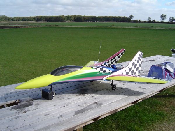

I have also just recently maiden flew my spot.
I have some videos of the takeoff and landing on a grass strip.
(Icant take credit for this perfect landing, as it was my instructer who flew and trimmed the plane in.
Ofcourse, the first time I tried to land her I broke the gear
Takeoff: http://bornholm.adsl.dk/modelfly/fil.../Keldstart.WMV
Landing: http://bornholm.adsl.dk/modelfly/fil...keldlander.WMV
My Hotspot with a Simjet 2300
)Ofcourse, the first time I tried to land her I broke the gear
