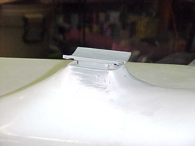

I PURCHASED A ROO ALREADY SET UP FOR A RAM 500 AND WAS WANTING TO USE MY MERCURY. HAS ANYONE DONE THIS BEFOR? THE MOUNT IS SOME TYPE OF CASTING MAYBE ALUMINUM.HERE IS A PIC. THANKS SCOTT

It looks, from that photo, like someone cut two RAM mounts and used the radial blade and about half of each mount on each side and stuck the radial blade down into the Roo pedestal. I would be wary of how well the blades are fastened to the pedestal. Pull and push like hell on it.
