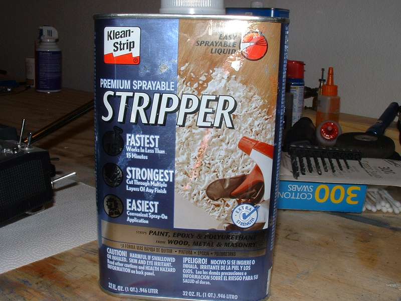

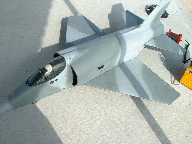

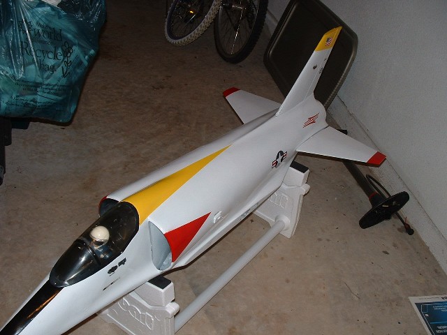

Here are some before and after pics. I took the after pics while the plane was wingless in the garage...the wings are basically white with red accents on the LE and the wing tip. Nothing cosmic, but I thought it turned out good for my first paint job. What I did was used the Kleen Strip formula that I bought from Home Depot and applied it. This stuff works fast as hell. I used about 4 rolls of paper towels and as soon as I sprayed the stuff on I began rubbing it lightly against the paint. It comes off quick so you gotta switch towels often. Kept doing that until all the paint was gone. Took about 5 hours total over 3 evenings. If anyone has any questions feel free to email me.
Luis

Bah,....here are the before and after pics

Heres a pic of the stuff I used

Nice job man!! It looks really nice, now we need some flyby pics
