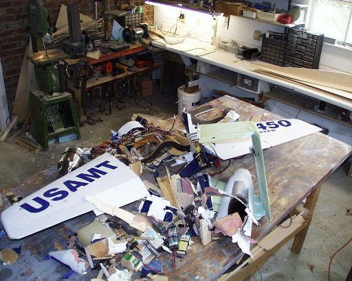

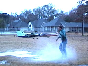

Well after a month or two of building,
then the first flight on December 22 2001.
Then at Jets over Deland January 28, 2002
was the first hands off hover flight.
On March 04, 2002 at Fl Jets it was flown forward
at low speed with a vertical landing.
On March 16, 2002 it was time to fly it forward like
a reg plane.
Also on March 16, 2002 it crashed... NO MO RIG
The turbine quit at ~40 mph and ~300 feet, it
should have glided better but at 35 lbs and 4 x 10 inch
fans, it glided like a set of car keys.
http://www.corpcomp.com/weeks1/movies/rigcrash.WMV
What was lost .. ? .. The plane is a wreck. As you can see
the airframe is a total loss. But that is it. All the tail rotors
are fine, batteries, gyros, speed controllers ect all OK.
The first rig airframe cost me a few hundred dollars.
The new one should not be very expensive as it will
have a Phil Nuza, molded nomex honey comb nose.
Molded fuel tanks (5-6 min instead of 3min), and heading
hold gyros.
The new plane should be lighter and able to carry more fuel.
(I hope)
Many people have said it may have a transition problem
going from zero airspeed to fast forward flight. On the last
flight this was some what tested, and I can say, this is not
a problem. Some of the hovering was done in 15-20 mph wind
and it worked fine.
As soon as I sell these 4 Isobar kits at Miss afterburner I will
get off my a&& and build R2.
Anybody want to help.. ? Baton Rouge LA,, any time.. ??
Eddie Weeks

The Rig has Isobar wings with about 1400 in^2.
This should have been enough to at least
pull the nose up, but I am starting to
think, the wings were too far back on the Rig
This made the Rig nose heavy, aerodynamically
and even with a 2 lbs of down push of the
tail rotor along with the large elevator
deflected at 50 deg, the nose did not come up.
I remember clearly, after the turbine quit,
the Rig nosed over, I heard off in the distance
the wing tip tail rotors spooling up. Even
at that distance I know I heard an RPM change.
If so it just produced a lot of drag, that's all.
Bob Parks is going to help me with wing placement.
(your never too good to ask for help).
Other than that, the new Rig (R2) will be much
the same, just lighter. (I hope)
Eddie Weeks

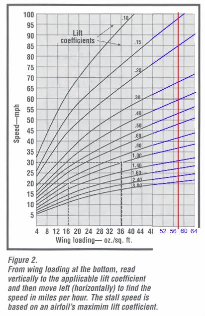

My condolences. I guess the rotor area is not enogh to autorotate
With a wing loading of 57.6 oz/ft*2 and cruising at around 40mph, by your estimate, you didn't have much of a chance of recovering from that low altitude. Here is a graph that I got out of "Basics of R/C Model Design" by Andy Lennon. The original graph did not include wing loadings as high as yours, so I projected the lines further out to the right (blue lines). Your wing loading is the red line. I don't suppose you know the lift coefficient of the Isobar wing's airfoil? If you do not know the lift coefficient of your airfoil Andy Lennon mentions that most airfoils have lift coefficieents of around 1.0. Assuming that your lift coefficient is 1.0 your stall speed projects out to 37 mph.

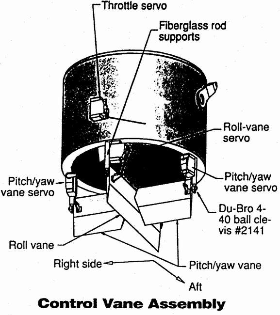

Tom Hunt's "Vertigo" (looks and functions much like your Rig) was able to get good hovering pitch and roll control with thrust vectoring vanes behind his tilting, ducted prop, power source. With vanes directing the thrust of your turbine for pitch and roll control you would be able to loose three of your four attitude control rotors (and thier associated batteries) for big weight savings and forward flight drag reduction.
The short moment arm of the vanes did not provide very good hovering yaw control though, so you might want to keep your yaw rotor. But then again, don't you always want to hover into the wind especially if there is a strong wind? So, maybe the limited yaw control provided by the vanes is all that you will need. Of course, redesigning your attitude control systems is a pain, but if you can't get the weight down and/or improve glide performance by any other means, you might not have much of a choice. Anyway, I have the plans for the Vertigo if you need more info about vane setup. Good luck with your Rig II. I have really enjoyed watching your progress with the first one :thumbup:

Are you familiar with the Vertigo? I would think that the Vertigo's vane setup would translate very well to your Rig. In the construction article, the only short moment problem was with yaw. In pitch and roll you also have gravity "helping". If the moment of the vanes was say 6" below the C.G., Consider a 30 degree right roll vane input. This would would cause the thrust vector to intersect the horizontal C.G. "plane" of your Rig 3" to the left of centerline. To get an idea of how fast a roll rate that is, put your Rig on a balancer that is 3" left of center and let the right wing drop. This will be pretty fast. Of course gravity will help the most when the Rig is horizontal (0 degree bank). If you tried to correct from a 90 degree bank (you'd be falling almost straight down if this happened, you'd also be at full power and accelerating horizontally) gravity would not help much, but aero dynamic forces would. The same will be true for pitch. With yaw, the assymetrical thrust will not have gravity to help, so yaw will be completely limited by the short moment arm.
The vanes don't add much weight, so they could be used in conjuction with your rotor system. Tests could be made at altitude by turning the rotors off in mid air. If the vane setup seems promising to you at that point, You could tweak the vane's authority while still having the rotors to "fall" back on. The risk of testing should be minimal while the possible benifits are many. It would look more like a jet without all those twirly bits on it too

Graig: I am very familiar with the Vertigo and
have talked a guy that has flown his many times.
I think the thrust vectoring idea just might work
but I am not going to try it. Putting fins in
a 900 mph air stream, just does not seem like
it would have enough control. I could be wrong
but I like to build things that are over built
and would rather have too much control than not
enough. And I don't care what my plane looks like
as long as it flies right.
Rig #1 biggest problem was controlling the control
(if that makes since) setting the gyro gain, took
a lot of testing.
Eddie Weeks

Its a long story but I will try to be brief.
The RPM sensor moved down and was eaten
by the compressor. It did not hurt the compressor
or even through it out of balance. This has
happens to me far more than any one else I know.
It was a slight problem with the AT280s but it seems
worse with the AT450.
As an AMT rep, its not my place to show fault
with the product I use. My job is to show
as many people as possible how well they work.
I was reluctant to tell everyone why the Rig crashed
but when I go to Miss next week, everyone is going
to ask where is the RIG ? So I have no choice.
Eddie Weeks

Yes... With any AMT you can download the last
30 min of ECU time and graph the RPM, temp ect.
The plane was beeping an error code of Low RPM
witch could mean a lot of things. But after seeing
the condition of the RPM sensor I was quit sure
that was the problem.
Once I get started, it will only take a month to build
a new Rig. I am not worry about it at all. That
loud a&& plane should have crashed long time
ago, with what we were trying to do with it.
I was test hovering it 2 months before Deland
and almost crashed it because I was giving the wrong
input, sometimes.
Phil flew it without a gyro one time and it was all over
the place.
It does not surprise me one bit that its gone. $50 of
balsa wood. $20 foam, $100 fiberglass and I will
have a new one. Its just not that big a deal. Thanks
again for all the support.
Eddie Weeks
