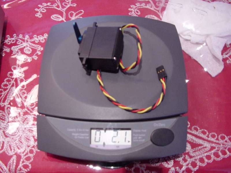

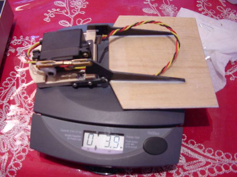

I have a Balsa SB that is built and ready for primer. I had been thinking about keeping the weight to a minimum too. I took some accurate weight measurements to see what can be done:
Speed brake: 4 oz
med servos 1.4 oz (for elev, ail, flps)
full size servo: 2.1 oz (for elev, ail, flps)

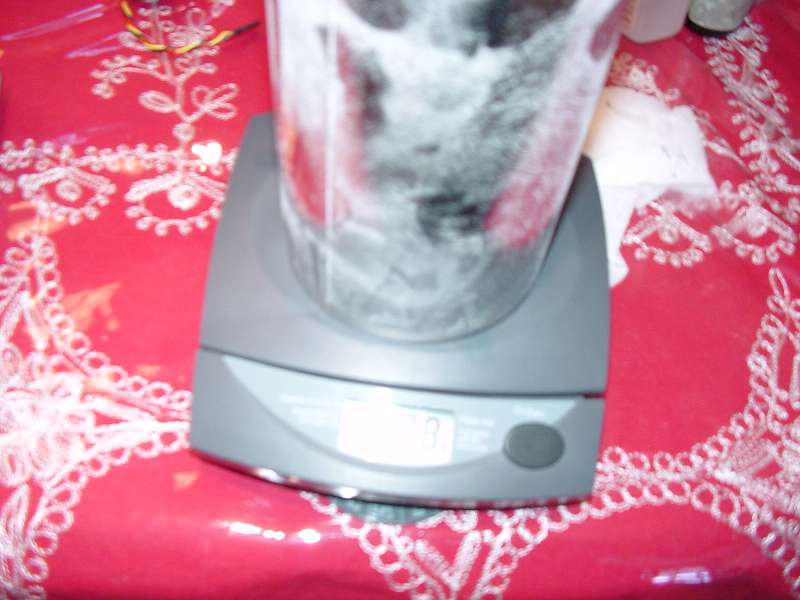

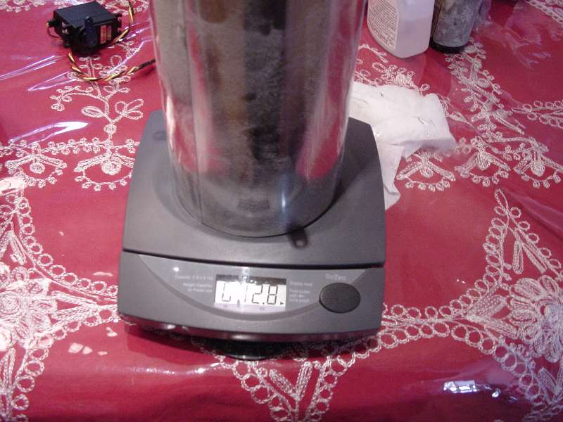

BVM SS pipe weighs in at 12.8 oz, Tam MAY be able to make a smaller one for a PST600R around 7-8 oz.

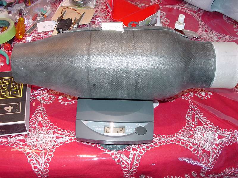

BVM bypass weighs in at 7.3 oz, may be one can delete it for an open bypass.

Speed brake: 4 oz
