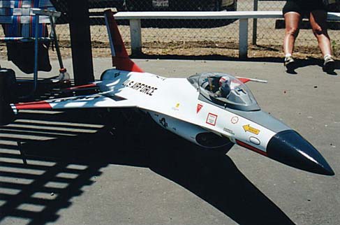

flyrcjets's Avatar
My Feedback: (30)
Joined: Jun 2002
Posts: 678
From: Roseville CA
Default Tuned pipe for OS .91 VR-DF
If you are using a Byron Fan..I suggest you use a Weston Mini Pipe!..I have the standard byron pipe if ya need one, but I'll never go back after using the Weston pipe! Best Wishes, Kevin
