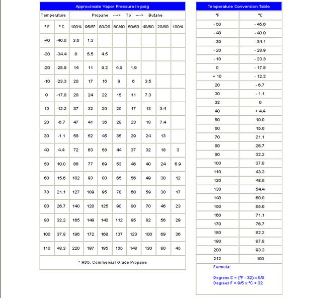

For the Jet Jocks here is a Propane / Butane mixture vapor pressure chart. Typical start gas mix (Powermax) is 70% Propane and 30% Butane. Bkf
