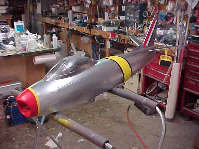

Just finished putting the bonder coat on the F86.I must say it has been an experience like none i have ever had .I must agree with B.V., you have to practice with this stuff.I have removed and reapplied the first stage multiple times, only to become more impressed with the look.Practice,Practice!!!!!Well just thought i'd share a picture and now on with the clear coat! Scott

Hey, once you get it done, post the tips! I have to do mine too this spring.

Looks Great Scott! Let me know when you will do the first flight. I would like to drive up and watch ( I love F86's!).

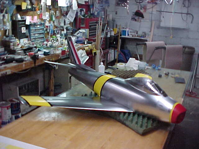

Just finished the wing and had to put it together to get the full effect. I applied the metal koak per BV's instructions and had no issues to speak of except the prep work must be smooth.Looks good even if I did it myself!hopefully the decal set will arrive this week.Scott

Looks great!
