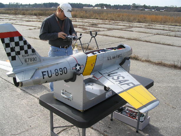

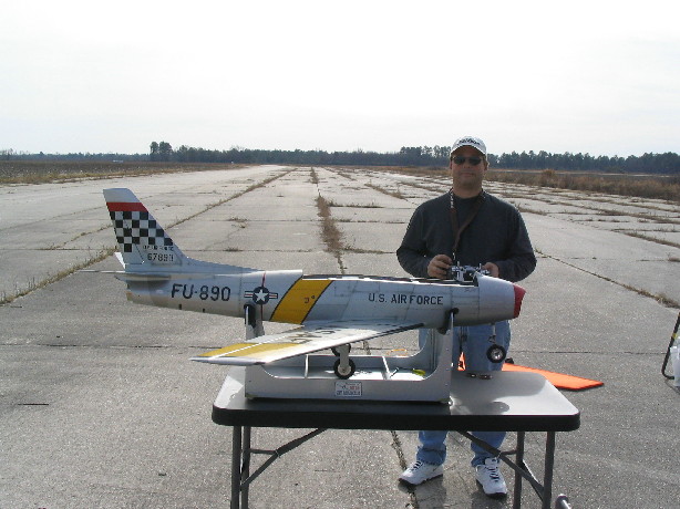

Date: Jan 1, 2004. Weather was a nice 69 degrees, clear Carolina blue skies, 1-2 mile per hour winds. 10,000 Ft runway. The day has finally come. Taxi out, flaps down, set brakes, spool her up, release brakes and away we go. Gentle climb out, couple of clicks right ale, one click down trim and everything is grovey. What an exhilerating feeling and sound. My first turbine flight.
For anyone interested, the Wren 54 is a very good match for this airframe(BVM F86).
I have a small video, how do you post it?

Forgot to mention, Big thanks to Anthony for all his help and steady thumbs during the first test flight.

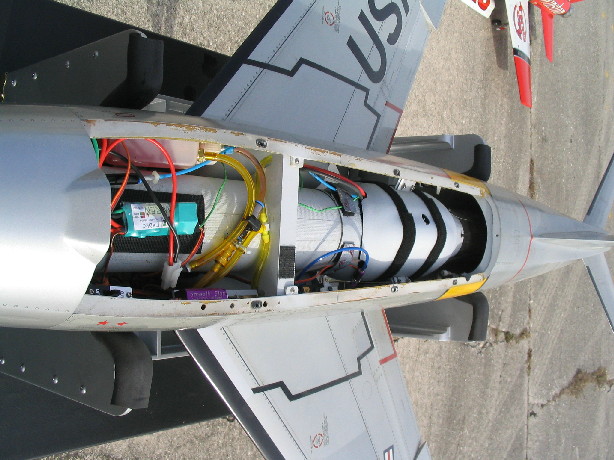

Any problems with the fully-ducted installation in the Sabre?

Flanker, Abosultely no problems using the full bypass. It is the only way I would consider. The bypass makes for a very clean, professional installation and certainly helps protect all internal airframe components. There's lots of room in the Sabre fuse as the enclosed photo shows. I would however, strongly recommend using the on board starter motor. I did find it difficult to postion the starter wand that comes with the kit into and out of the bypass. For an outside the airframe installation the starter wand works fine. The starter motor simply bolts onto the front case with three small bolts. I put a Tamiya connection on my and use a six cell pack connected to a momentary on-off button in a small ground support box (Radio Shack). Simply plug in, push the motor starter button and the process begins.

I can confirm that there is no problem with fully ducted installation, as has been said.
The other thing to consider is drag, the full ducting considerably reduces drag from the airframe.
Jason flys a BVM Sabre with the new test Wren Supersport 54 turbine, fully ducted, with 18lbs of thrust.....ballistic!

Thanks for the info on the full ducting. The reason I ask is that on other threads, Larry Wolfe has stated that Wren suggests not going with fully ducted installations with the MW-54. Others have also talked with Wren confirming their suggestion.
Technically, it doesn't make sense to me. A well-engineered duct like BVM's should work great. I don't buy the argument for a plenum inlet--it's just so draggy!

I have a Wren MW54 Supersport prototype and have it fittted in a BVM F86 Sabre in a BVM RAM 500 bypass fully ducted instalation and it is perfect.The reason Wren may have said not to fit the engine in a fully ducted instalation is maybe because when this engine was fitted in my sabre 10 months ago it was shuting down at idle and was originaly thought to be a ducting problem, but the problem was later traced to the normally brilliant Hausal fuel pump ( the same one as simjet, jetcat, RAM and many other engines use).Once the pump was replaced it has never stopped and has now logged well over 100 flights and over 12 hours run time.This plane seems faster than my P120 powered S/Bandit with this instalation. My sabre has the standard 1.7L plus the U.A.T and I normaly call landing on 7 mins, land on 8mins and there is enough fuel for a few go arounds and with economy like that and 18LB thrust this engine should be well sort after when its available later this yr.
