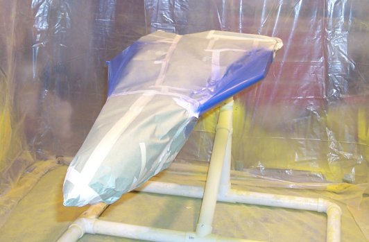

I thought I would share some pics. of a very inexpensive paint stand I made from 1-1/2" PVC pipe. I was unable to attach a picture so I put them in my gallery, just click on my gallery below
I built this in about 30 minutes and it cost less than $10.00 for materials. Installing the upright at an angle backwards keeps the fuse weight centered on the the upright and also makes the fuselage level on the stand. The bottom legs are three feet in length to keep it from tipping forward. It works great!!
Also, the upright post is attached at the bottom with a 1/4"-20 bolt so that the upright can be removed for easy storage. You end up with two pieces that can be stored flat against the wall of your workshop...Gary[8D]

Don't you just love PVC!!! Nice stand.

JR, it's almost like duct tape, it has many uses. You can make all kinds of stuff...Gary

Gary:
I "borrowed" Todd's paint stand design last year. Works great. Your design takes into account CG! My "stolen" design uses a 45 degree brace to stabilize the stand.

Nick, how are you? The 45 degree brace on Todd's stand looks like a good idea, I will probably need to add it to mine for heavier fuselages but the F-86 fuse is so light I did not need it right now. I know you guys are working on something, so what are your winter projects?

On the 45 degree bit, one could take a couple of short pipes - drill a hole on one side, then drill another hole on the other side to match the angle you want. Once you have one, you can the get another set of pipes with different angles so one could have different angles to handle the different weights.
Just an idea...
