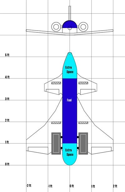

Hello all.
My friend is in ROTC (we're both 15) and we came up with the idea to build a jet fighter as his senior project. The motive was his goal to become a piolot and mine to become an architecht/engineer. The idea was, however, mostly a fantasy until I started looking into the subject.
The first place I turned was learning about jet engines and aerodynamics. I went to that cool NASA site where they have everything anyone needs to know about planes and turbine engines. I then began searching for any information at all.
Shortly after I drew up a design (based off of complete guesswork) and continued my search. Sofar I've come up with 6 or 7 designes, each one based off of more information i've learned.
Not until recently did I discover there is a whole community of you people who do this all the time and there are more types of affordable turbojet engines than the crusemissile one I was drooling at (with 150 lbs of thrust.... sweet jesus).
So now I've come a long way (having read a few books and sites about aerodynamics and flight) and these are my current specs:
I'm planning on using a fiberglass body with sheetmetal re-enforcement (I will explane why in a bit). It's total length is 6 feet with a wingspan of 4'.
I'm one for the ponies so i'm going to strap two p160's (from JetCat USA) on it with a 3' by 8" (diameter) fuel capacity (by my calculations that's 7.833583 gallons allowing for 31.334332 min of flight at full throttle (using a calculator and given fuel consumption)). This allows for 68 lbs. of thrust at full throttle (34lbs per engine). I noticed that most of the planes discussed are like 10 lbs of thrust... thus I am re-enforcing it (with sheetmetal ribs and sutch in potential stress points).
Inside of the fuselodge I am planning on having a few cameras (with some kind of radio transmitter) so we can see an on-board view of what is happening, the control's (and their nessisary radio components), fuel pumps and some kind of device to suply the heading, airspeed, altitude and all that other fun stuff.
Here is where I submit my situation to all of you to help give me advice.
The design I have is Canard (has the stabilizors infront of the center of gravity) because it looks cool
and also because the engines are mounted quite far back and I want to ensure that my stabilizors wont be melted off by the exhaust... and it looks cool. I am aware of the stability problems with this design as it causes a risk of the plane flipping over when pulling up[:-] (because the stabilizors lift increses infront of the center of gravity).
To make up for this danger I am making the stabalizors smaller and the wing larger, reaching to the back of the plane (similar to a Tailess aircraft design).
It is my theory that a Canard design with stabilizors that arent so large that they flip the plane over would allow for a much tighter radius when pulling up - but could increse the risk of stall (thus I'm pondering putting slits in the wings to reduce this risk).
Other details include:
-It is swept wing...
-The wings are tilted verticaly...
-The fuselodge is 8 inches diameter.
I am awaire that it is NOT a good idea to start my model flight career with an expesive and FAST plane (due to the risk of crashing) so I have enlisted the aid of my old science teacher (an experienced pilot) my friends brother (a cal-tech student and pilot in training) and am planning on getting Flight Simuator 2004 with the model creation software (crammen on the simulators so we have a "feel" for what it "might" fly like).
Now that I am done ranting these are my questions:
1 - I'm guessing (or hoping... pending how one looks at the situation) that the plane will be arround the aria of 50 lbs fully loaded... If someone see's that I'm probibly totaly off please do tell and give me you're estimate of how heavy it will be.
2 - With 68lbs. of thrust and a 50lb design... is there a risk of going trans or super-sonic?
3 - Any ideas on wing size and shape? I have one but it's based compleatly on looks.
4 - INPUT... i'm new to this.
Oh and he're is a basic pic of the current design (with half the fuel tank capacity)

Ralph (Turbulence) is correct. Also, even if you do get something airworthy sooner or later, do not make the mistake of thinking that an experienced full scale pilot can easily fly this. That is not the case. Everyone is different, but most of us flew R/C for several years before being able to handle the performance of a hot sport turbine jet. And what you are dreaming of is hotter than the hottest out there. If you really want to pursue this, get a good flight simulator and practice. When you have it right, join a local club, start with a 0.40 sized glow trainer and work your way up for a few years. It will save you A LOT of $$$ in the long run.
In regards to your question #2
With your calculations of 7.833 gal of onboard kerosene which weighs 6.8421 lbs/gal, your fuel load would measure 53.5941693 lbs which means your air frame would weigh a minus -3.59 lbs, rounded off. So the answer to your question would be no.

With two P-160's, if you keep it light it will go supersonic.
You could also add a glow plug to the tail pipe and pump some butane and you will get a cool looking afterburner.
Make sure you wear binoculars just in case youn loos it out of sight. Also, don't break the sound barrier over continetnal US, or you amy get in trouble with the FAA, and the NSA for that matter.
I can give you a good idea for an ROTC project. Build a Great Planes Patriot which is a propeller airplane but looks like a jet, and it can hit 100mph with a good engine. There is a good chance you could actuallt fly this one, although it is still pretty fast. Always seek help of an RC pilot, never a real pilot. It is very different to be seating inside an airplane than outside, the perspective is different. Building a patriot or similar will teach you the basics about airframe and systems installation, and you will not need to ask the Department of Defense for a grant. You can even install a landing gear system that retratcs just like real airplanes.
Good luck, and forget about turbines for your project, unless you only want to design and not build.

Sorry boys, this project is way out of your league
. Suggest if you really want to do a project, design an airplane..... build it and power it with an electric motor. Just designing a plane that actually flies will be enough of a challenge for you

i'm not sure if you guys are getting the message here from the experienced fliers.
the reason there is a bit of sarcasm and reference to "being 15", is basically becasue the pilots/builders here know that what you have proposed is going to be virtually impossible for you. When i say virtually, it is figuratively speaking, as nothing is absolutely certain (see einstein's theory of relativity and uncertainty principle). But i'd bet with about 99.99999999999999999999999999999999999999999999999 999999% certainty that this one wont happen.
there are aspects such as costs, materials, aerodynamics, parts, time, weight..and then the flying stuff...
i agree with other here about trying to just build a flying aircraft.
these posts are more a reality check then discouragement. Reality is something you'll need to apply in terms of assessing a project's feasibility when undertaking any engineering endeavour.
