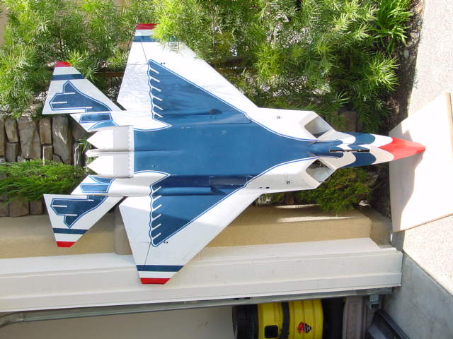

Hi heres some pics of the original george miller yf22 proto type this was the actual proto type it has been recovered from storage and gutted and rebuilt its said to have 500 plus flights!

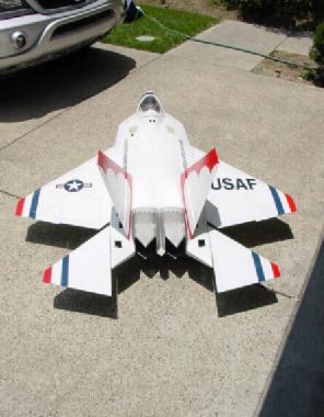

Default F-22
Pic

Default YF-22
Beautiful plane.
Can you post more detail picture of power plant,landing gear ect.
Should be recieving my Craig Aviation kit next week.Been waiting
three months.Need to see how you were able to get gear doors
to work.Heard it is a nice flying jet.Will be turbine powered.
Thank you for your responce.
Old 06-01-2002 | 09:05 PM
My Feedback: (7)
Posts: 792
From: anaheim, CA
Default Yf22
Hi I used nelson hobby piano hinges for the doors and used mid mini servos whith a door sequenser a lot less hassel than air the gear are spring air I wood up grade to strutt capable spring airs the kit you will get will need some modifacations I used a special torque rod set up and this plane was ducted fan it was built before turbines were a every day thing so I figured to keep it ducted fan I did install intake ducting and changed a few things my freind did build a turbine craig kit flys great we will fly on thursday and post some pics!
