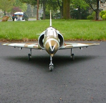

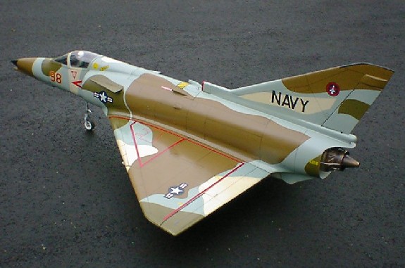

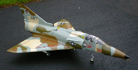

Old 03-15-2004 | 06:00 PM
My Feedback: (61)
Posts: 844
From: Middlesex, NJ
Default RE: JHH Mirage conversion
The JHH Mirage is actually pretty easy to convert to turbine with minimal reinforcement. My Friend (George Leu) and I took my old airframe that was flying with a .45 fan unit and recently converted to turbine using an old GWM FD3/67 engine. I am waiting for some better weather conditions to test fly this plane but am confident that it will be phenomenal. I mounted the turbine all the way in the tail and still balanced the plane without any nose weight while saving a lot of weight by excluding the bypass/tailpie etc. The wing is all builtup as per the instructions. The total weight of the airframe is around 9lbs dry with accomodations for 64 oz. of fuel. I believe this plane was the subject of the RCJI magazine a few issues back. The second part of this article is waiting for some flying experience and pictures. Here is what the plane looks like currently.
Thanks - Adil

Old 03-15-2004 | 07:02 PM
Shok's Avatar
My Feedback: (28)
Joined: Apr 2003
Posts: 3,886
From: Heath, TX
Very nice.
How do you access the engine with it sitting so far back?

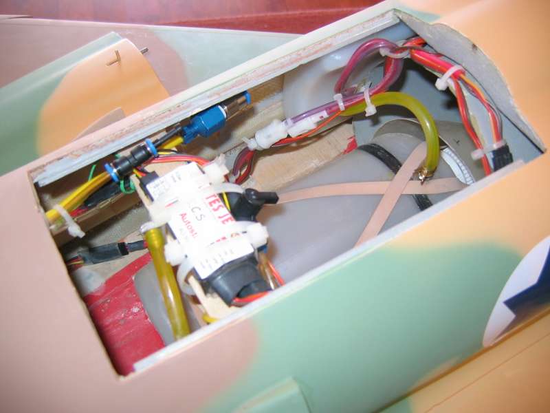

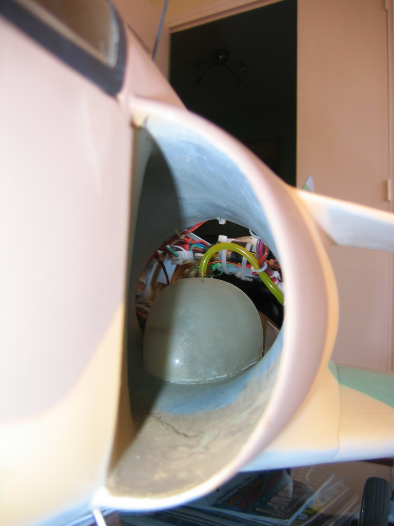

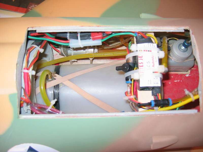

Old 03-16-2004 | 05:55 AM
My Feedback: (17)
Posts: 1,096
From: Chevrieres, FRANCE
Here are the pics,
I also have some video but someone has to explain me how to post it.
As you can see it is very simple, may be not as tidy as a bypass but it works very fine and the engine runs really cool.
The tank is a sullivan DF tank feeding a one liter bottle feeding a BVM UAT. I get 9 minutes flights at full throttle with this.
The aircraft weight is 5.6 kgs empty.
Last thing , this mirage is over ten years old and was being flow with a Dynamax fan before....[8D]

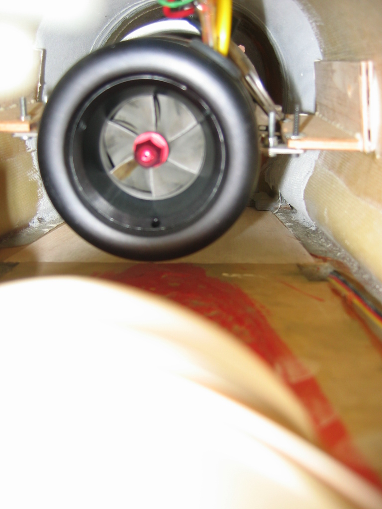

Old 03-16-2004 | 05:56 AM
My Feedback: (17)
Posts: 1,096
some more

Old 03-17-2004 | 04:09 PM
TJK
My Feedback: (69)
Posts: 324
Received 2 Likes on 1 Post
From: Camp Hill, PA
Adil and Rider-60,
Which wings are you using? JHH offers 3 options; scale 36 inch wing, 40 inch foam wing, and 45 inch sport wing. I have a JHH Kfir kit that I would like to build with the scale wing, powered by a GW FD-3/67. Larry at JHH recommends the foam wing, with it's increased area, for carrying the weight of a turbine installation. Do either of you have an opinion?
Tom
Old 03-17-2004 | 05:57 PM
My Feedback: (61)
Posts: 844
From: Middlesex, NJ
Tom,
I have flown the JHH mirage with all of the different wing options. Mine is the all built up wood one from his plans which I believe comes out to be about 42". I would definitely agree with Larry here as fas as the wing goes. The scale wings version will be a true handful as it is already with the DF set up. I would go with the foam sport or the built up version. I personally believe that the built-up version is stronger and much lighter than the foam version. It was also easier to work on while installing the gear etc.
Hope this helps.
Adil

Old 03-19-2004 | 06:43 AM
Joined: Mar 2003
Posts: 4,575
From: New York, NY
Try this one, it works better for me :
http://pageperso.aol.fr/FColombet/Kfir%20take%20off.WMV
Old 03-19-2004 | 08:47 AM
Shok's Avatar
My Feedback: (28)
Joined: Apr 2003
Posts: 3,886
From: Heath, TX
wow, man that thing looks like it's got plenty of power!
