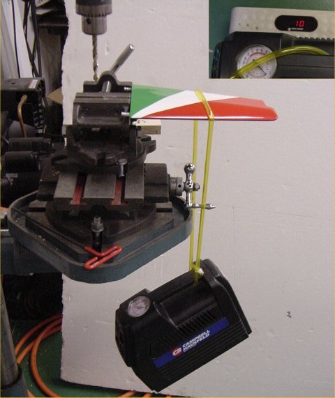

Nice pic, however that is meaningless, the stab seperated from the fuse it did not snap off in the center. The concern is not the strength of the stab but how it is attached to the fuse. The forward pin that slids into the retaining tube to hold the stab in place at the leading edge only protrudes 1/4 inch into the stab. It needs to be longer. The stab after the crash was not broken in half it was in one piece, it had ripped away from the fuse because the forward pin was not long enough. Tam is the one who assembled the kit and he has been shipped the stab for inspection.
Give me your email address and I will sen you a picture, this is a large file so it will take a while to down load on a standard telephone line. Send me your email address to

how long is the part that is being held in the vise?
Re: the piece being held in the vice, how is it held in the fuselage? Is it a tube that goes all the way through the fuse?

This a emai lI recieved with some adive I thought I would share.
Thanks for the photos.
> Sorry about your disaster with the '339. Your photo
> shows that the stab was
> not properly adhered to the fuselage, there is no
> glue adhesion on 75% of
> the gluing surface on the stab. But, the spar and
> the alignment pins were
> firmly anchored in the fuse (they were notched to
> give a good keying surface
> for glue), as designed. But, while this contributed
> to the stab departing
> the fuse, I do not think this is the initiating
> cause of the loss of the
> airplane.
> Both front and rear alignment pins were ripped out
> of the stab, and the
> aluminum spar was sheared. which tells me that there
> was severe
> back-and-forth rocking before failure - most likely
> from a flexing or
> dislodged elevator linkage causing stab surface
> flutter. The aerodynamic
> trim tab effect on the stab amplified the elevator
> motion to destruction.
> The front alignment pin is anchored in a balsa block
> the stab, and the whole
> block ripped out, as did the rear alignment pin
> (note elongated hole and
> ripped bottom skin).
> You may find your servo mounting dislodged, and
> linkage damage as well - of
> course, it's going to be hard to distinguish from
> damage after the crash.
> I do not think that making the alignment pin anchors
> any stronger would have
> saved your airplane, unfortunately - IMHO the root
> cause of the failure was
> elevator surface flutter, and you would have lost
> control anyway. A
> stronger joint *might* have delayed the stab's
> departure from the airplane
> and allowed you to slow down enough to stop flutter
> (if it was springiness
> in the linkage and not servo mount failure).
> I will be recommending to customers to roughen up
> the stab-fuselage
> interface with #200 sandpaper for a better keying
> surface and then wiping
> down with denatured alcohol before gluing to remove
> any traces of mold
> release, for better adhesion. The same should be
> done on all servo mounts
> adhered to the inside of the fuse.
> In addition, extreme care should be taken to ensure
> a slop-free,
> mechanically "stiff" (i.e., non-springy) control
> linkage, to avoid exciting
> aerodynamic flutter in the elevator. I personally
> recommend 4-40 linkage
> hardware and a supported pushrod rather than a free
> floating pushrod, in
> case of a long pushrod run.
> Again, sorry for your loss, and thanks for the
> photos. Compliments on your
> very nice P-80 and the beautiful home in the
> background!
> As I am not on RCU, I would be indebted if you would
> post this message on
> the board for me. Thanks!
> Andy Low
> ElectroDynamics, Inc.
> Home of "No-Hassle" RC Products
> http://www.electrodynam.com
