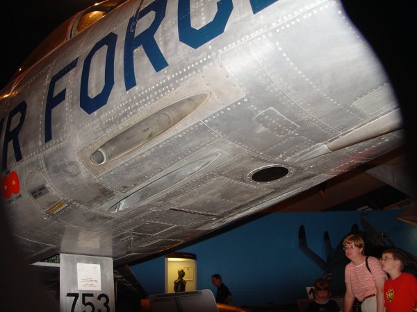

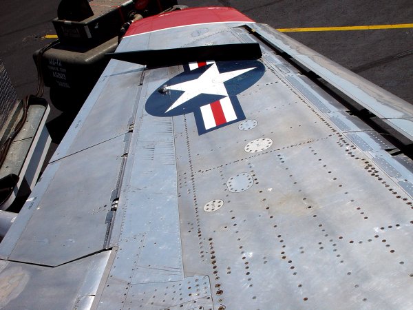

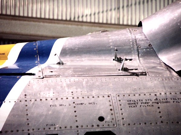

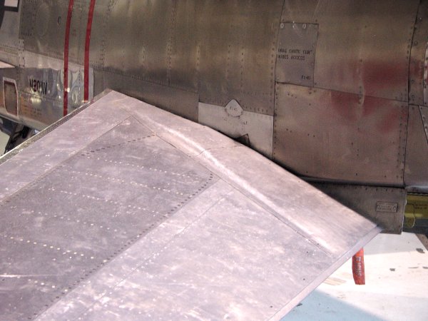

Default RE: Questions about Rivets
I can see these.
It depends on what model and If it is painted. Paint will cover rivits. Bare metal airplanes will show rivits easily.
Scott
