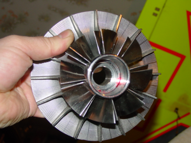

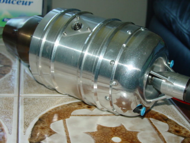

Hi, I'm not sure if any of the engine guys amogst you can help with something that has been puzzling me.... I have built an engine which uses the AMT Mercury(20lb thrust) wheels and naturally assumed I would get similar performance to this commercial engine. My engine has now completed some 2 hours flight testing, (around a dozen flights), with max power dialed down by 10krpm, so on paper for this rpm I would expect maybe somewhere around 15lb thrust max ? But the Super Reaper the engine is installed in has a t/o weight of around 23lb and goes straight up after rotation.... this just doesnt seem to add up.
Another guy flying a Jetcat P80 powered Super Reaper asked what my engine was because in his opinion it had better flight performance than his ????
Fuel efficiency seems good with only 1.5litres (around 40ozs) used in a 10 min flight, this may be because of the lower set max rpm.
I have downloaded the flight data from the Fadec ecu and the engine is definately only *****g out at 140krpm with max temps in the mid 600C area, this rules out over revving.
Any theories as to why this is happening ?
Rob.

Not sure what the thrust is, I'll bolt the engine in the test rig and check it, but I would not be expecting more than 15lbs at this conservative rpm setting.
The turbine wheel is 65mm, the exhaust is modified AMT (demountable) but all the critical dimensions are the same. I have modified the diffuser system, not sure if that is producing more case pressure.
Another unusual trait the engine exhibits, similar to the TJT 3000, is the lack of noise, it really is very quiet in the air, just the exhaust efflux roar on higher throttle settings.
Rob.

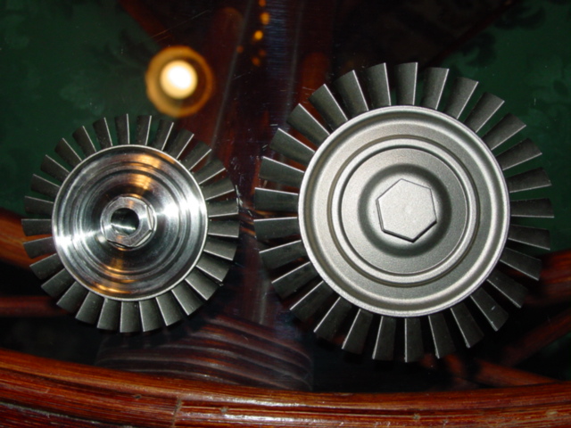

Hi Jason,
good to hear from you again, hope you got sorted with a longer thermocouple for your MW44 ?
The ngv is again a modified AMT item, the critical vane geometry is unchanged but whereas AMT bolt their shaft tube solidly to the ngv mine uses a TJT tube with a sliding interface and bearing carriers.
Turbine wheel is definately 65mm as you can see in the size comparison with the Wren 66mm wheel and the diffuser is only really modified to try and improve airflow to the front face of the combustion chamber due to a chamber/diffuser gap reduction.
Perhaps I should build a second engine with the parts I have to see if this first one was just a fluke
Rob.

So AMT ngv is bolted on to the the bearing housing. I like that setup better, Before assembling the case you can tell if your turbine wheel and the ngv is align properly sweet
I always wonder how AMT all in one case and cone work.
Looking at your caliper reading your turbine wheel 65.20 but your ngv 65.15 ??? . How many injectors your engine as ?.
I'm doing some experiment my self with a 32 lb engine. Its running ok with EGT of 480 max power.

If you look at the throughput area of the AMT wheel you can see it is much less than the Wren 66, so although they are of a similar o/d the actual 'working' area is much reduced. The AMT wheel is designed/built from the outset for high rpm(150k+) the same as the 60mm Garrett compressor wheel up front. I burned many litres of fuel at max rpm before commiting the engine to an airframe.
The shaft and turbine wheel were machined/ground to within a couple of microns runout after a few heat cycles to allow the hot components to 'settle'. I then spent an evening concentrating on getting the rotor balance as good as my equipment would allow.
The turbine wheel/ngv tip clearance is just enough to avoid any 'rubbing', this I am told can lead to better fuel efficiency.
I thought the engine would sound similar in the air to an AMT but it's completely different, possibly due to the turned from solid alloy casing.
Next project engine will use the wheel on the right Shaft has just been turned ready for final grinding to size.
Rob.
