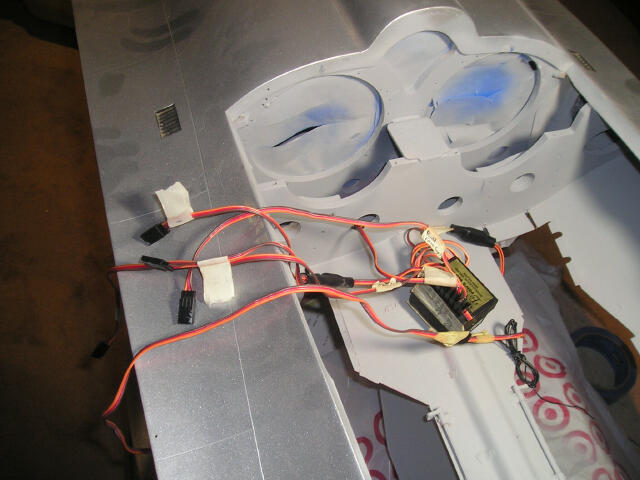

Unlike many of you knuckle heads out there, I have to disassemble my Kingcat for transport. So, what's the big deal right? well...today I barely averted disaster when post landing I discovered a lousy connection between my 36" lead from my rx and my booms. This connection allowed an intermittent signal to reach one of my stab servos. The result was a mild porpoising action of the airplane. fairly spooky because on deck it shows no signs of going south when you do a wipe out of the controls.
I'm using Cermark connections and one thing I've discovered on both of the 36" extensions I've replaced is that the sheath that covers the pins is shorter than the standard JR connections. This lead me to believe that perhaps they were defective but upon further inspection I've discovered that there's an optical illusion with the sheath they use. I confirmed the solid connection by using one of those yellow parson's connector.
so, ultimately what I want to convey is ensure you get a solid "snap in" connection when you press those leads together. I didn't pay close enough attention to mine and narrowly averted disaster.
I know there are a number of ways to secure our leads "heat shrink", "tape", "mini zip ties" whatever but however method you use if you take them apart for any reason just don't assume because they press together that you have a solid signal.
do a control wipe out prior to taxing out of the pits, hold short etc. you just might discover a problem. I did.
take care

In addition.. just a reminder to be careful with your choice of connectors in-line. We (at JR/Horizon) have seen some pretty severe resistance jumps/voltage drops from some of the 'discount' connectors on the market. They are NOT all created equal. When you start stacking multiple connections in-line between receiver and servo you can see as much as a 2v drop at the servo, making that nice 200oz" servo put out far less torque than rated.
I guess the short version of this is "Your radio setup is not the place to save $$$". It could wind up costing you a lot more in the end.

I'm not sure you knew that I almost lost my Bandit at Tucson on Friday....I had a cheapo 3" extension between the switch and the RX and it went south as I was in the flare....Vinnie was spotting and said "Man that was a carrier landing"...I told him I only intermittently had it down final and in the flare.....
I don't know how that cheapo got into my Bandit.....must have been the only 3" extension I had handy.....
I use nothing but JR heavy duty or Andy Lo's cables and switches from ElectroDynamics/Cermark, and SR Nicads with the 18 ga leads.....and Duralites......
Over the past 4 years, I lost a HotSpot and Bandit to electrical frig-ups......doing my best now to avoid another disaster.....

I didn't know about the near loss with the Bandit. Much like mine I guess, intermittent signal. we were able to get the servo to react on deck much like it had in flight. twitching up and down, which would translate into a mile porpoising motion. that's two connectors that went bad. what are the odds?
saving near 6 bucks an extension on a project the size of the King = a sizeable chunk of change but in the end game is it really worth it? I'm going to take a different approach for the next project.
I'm sure it's not typical and perhaps is just an isolated event. however, I just wanted to pass and "airframe directive" if you will to raise and "awareness".

I think this is why BVM states in the Kingcat manual that you should use only JR heavy duty gold plated leads with your JR radio gear.
Over the years I have found that many of the off brand "after market connectors" do not make a good connection to the JR leads. I use Hitec servos and receivers for prop planes and in this case I do use Hitec servo leads. I think it is a good idea to stay with whichever brand you are using for all connections.
This is common sense I guess if you think about the fact that the pins in the connectors are not the same type of connector pins, same manufacturer, etc. In the past, I have disassembled two different brands of male plugs and measured the pins with a micrometer and there can be a substantial difference in pin size which will probably not make good connections to JR equipment.
It was very expensive for me to buy all JR brand leads for my Kingcat but I think it does eliminate any potential problems in this area and it is not nearly as expensive as buying a new Kingcat. Gary

If you look at the female plugs from different brands you will see that where they are crimped to the wire there is a difference in the way the crimp is made. I would think that if they are all the same and come from the same factory that the crimp would be identical but they are not so I think I would disagree also that the connectors are all the same. If you disassemble the plugs you can see the difference in how the pins are made as well. The physical appearance is different.
And there is no doubt at all that some do not all fit together properly to JR plugs. I currently have several different brands and some pull apart from JR connectors very easily but when two JR plugs are pushed together you can feel a positive locking of the plugs and they are much more difficult to separate.
The other thing to keep in mind is that just because mis-matched plugs feel tight when pushing the connectors together really does not mean anything. Some of them are tight because the plastic housings do not fit properly to JR connectors and it has nothing to do with how well the pins fit together which is what is important. Therefore going by feel really means little as far as how well the connectors will work.
I think there has already been a comment about the high resistance that can be created by improperly fitting plugs which will likely result in reduced power to the servo from the improperly fitting connectors.
In my original post I had mentioned that BVM recommends using only JR connectors with JR radio equipment. After having quite a few of the BVM kits I know that their equipment recommendations are based on past experience and extensive testing and I have learned to trust what they say and recommend. Based on this I believe that there are good reasons why BVM has recommended using only the JR leads for JR equipment...Gary
