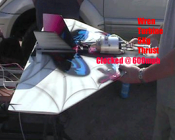

600mph ?I found this on denmarks rcu.

ORIGINAL: daytona kid
where is the fuel tank?
600? How could he see it to fly it??
Old 05-14-2004 | 08:49 PM
MAX EFFFORT's Avatar
Joined: Aug 2003
Posts: 491
From: , TN
Default RE: World Model Speed record???
I don,t know anything about it. just found pic on denmarks rcu...text was in language of denmark. don,t speak denmark.

ORIGINAL: Shok
Appears like you´ve been a victim of AMA brainwashing ("there cannot be what DB and/or the AMA EC - those guys who know so much about jets [sm=lol.gif] - believe to be impossible" ). I´d take you serious if you would say that YOU could´nt control a jet at such speeds, and I cetainly couldn´t einher. Heck, I can´t even jump 8 meters wide!
But I am sure that neither you nor I are the yardstick of model air - nor any other type of - SPORTS.
Peter
