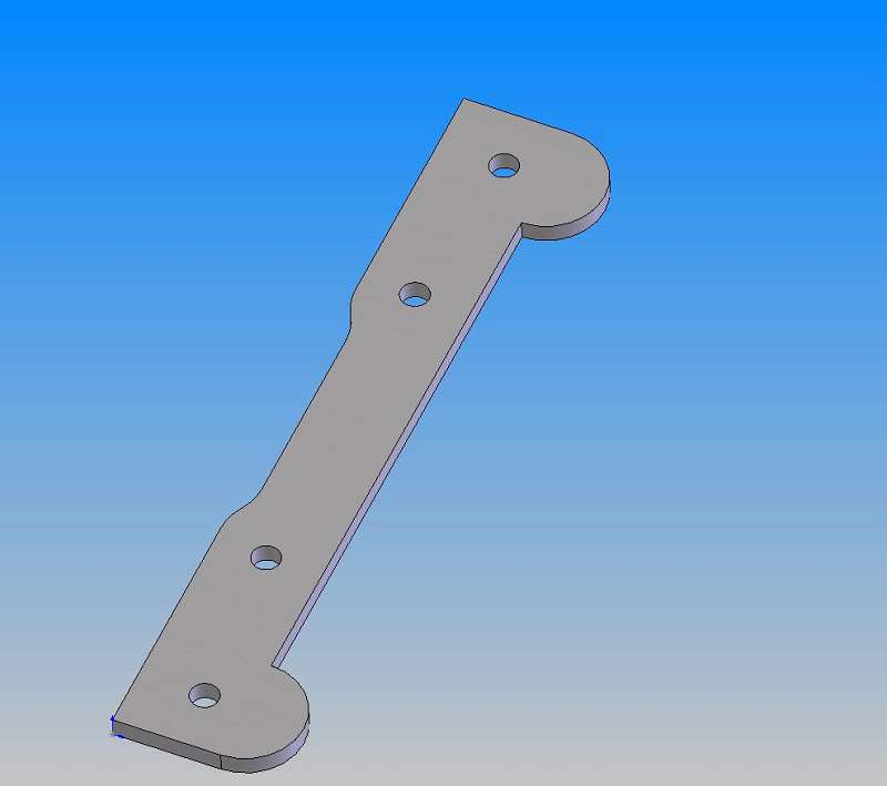

I am building a hand full of Titanium flex plates for a friends Super Bandit..
The Material is 6Al-4V Titanium witch is very very strong and light...
I was just going to make a few of them but does any body else want some..
They are $75 per plane (six pieces) mostly because of the Material cost..

Those are very cool. I wonder where this moves the fail point to?

Will these flex plates fit the Balsa Bandit? Besides being very light and strong, does titanium exhibit more resiliency?

LOL - I know watcha mean ... a fellow clubmember kept bending the wire struts on a pattern plane when landing it, so came up with the perfect solution ... titanium gear legs. Sure enough, they didn't bend on the next "landing" - tore the whole darn wing apart instead !

My initial question sounds kinda jerky, I did not mean it that way!
I have seen reinforced flex plates hold up to some incredible loads in a composite bandit, the structure is very strong. I just wonder how it will finally fail.
My guess is it would pull the mounting blocks apart, which might not be too bad. The old failure mode always cracked the top of the wing.

I doubled up the rear carbon fiber plates on my Bandit and never had another failure. My experience was the strut tended to bend on the less than perfect landings. The structure is very strong. Easier to replace bent metal than bent paint.

I would much rather replace or straighten a strut rather then have to do paint work to the wing. It will take a real pounding to tear up the mounting points for the flex plates in the composite wing. The Titanium has a nice flex to it count me in for a set

With the pattern airplane struts at least.. we found the titanium wouldn't bend but instead would just break. It took a lot more force to actually break them than steel but they never bent.

They will get cut this week and installed next week.
When I am satisfied that they fit and are strong enough I will
start shipping....
I guess I will just take my friends Brand New Super Bandit and
drop it from lets say, 1-2 feet.. That should be a good test...
