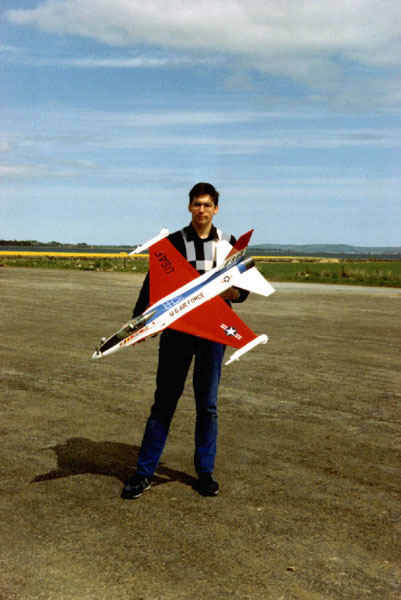

ORIGINAL: Neil Guildford
Sorry to have to meet on these terms, yes I won the bid. (theres another one in the US for sale and last time I looked it was at $39.99.
I was going to use HS81 Servos.
Finally, have you a photo of yours or any building tips.
Sorry? You did me a big favour, I do not need yet another model to add to the queue waiting to be built. I must keep chanting that!
I would not be keen on HS81, even the mg version, the gears are very small and easily stripped by vibration/flutter of the control surfaces. Go up to mini like 225 rather than micro servos.
My only building tip is do everything to remove material and weight. When you have carved the leading edge root extensions look at hollowing them out to remove weight. The planking is a pain, and needs a lot of filling between planks, which is why I thought of 1/16 sheet. I would epoxy glass the model, but I am confident these days of my ability to do that with no weight penalty. I seem to remember it screwing out of loops and I put it down to elevator differential cause by rotary motion of the servo, I might think about a servo per side.

Hey guys,
Correct me if I'm wrong but wan't the old EZ F16 as well as their F18 pushers?
The pics that I see show the eng mounted up front, unless this is a modification of the
original plane.

This kit was always for engine at the front. It is not an EZ kit, this is the original Pilot brand before the EZ Pilot brand.

Nice plane Harry.
I hope I can finish mine to that standard.
Your worrying me about it flipping in a loop. Could that have been due to excessive elevator or a tail heavy plane?
What would you say the maximun size prop is you can use?
Just Engines are selling the Leo 37 and purple pipe for £75.00, so thats a sure bet on the engine.
Old 04-22-2004 | 05:09 PM
Posts: 3,672
Received 26 Likes on 16 Posts
From: private, UNITED KINGDOM
Default RE: F16A General Dynamics by OK Model-Pilot
It wasn't a major hassle, just that it didn't track straight and needed aileron to keep it in line. I can't remember the exact elevator pushrod setup, is it some kind of T bar from the servo to connect to the arms on each tailplane pivot? Differential elevator is always a problem when one servo drives two separate elevators, due to the rotary motion of the disc. One way of solving it without carrying two servos, is to mount the servo on its side, that way the rotary motion of the servo disc is up and down instead of side to side so there is no differential movement.
Another weight saving strategy is to try AAA cells for the Rx instead of AA.
I seem to remember that flying had just two throttle settings - full throttle, and one notch back from full throttle to land! It's a little wing to carry a big engine, retracts and 5 channel radio. If you can knock a pound of weight off it it will transform it. I would not have been bidding for it if I didn't think it worth having again, but do be prepared to have to fly fast at lift off and landing approach, it is a very small wing!
Ahh memories! Those two photos were taken way back in 1987 and I hadn't looked at them for years.
