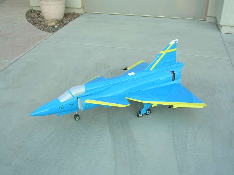

Well, folks, I've been test flying my latest and possible first for that matter, jet project this week. Way back in 1977, my father and I started to design and build a Saab AJ-37 Viggen. We were going to use the soon to be released World Engines Jet Pump fan designed by Duane Johnson. The project languished in the basement through a couple career changes and marriages and finally the passing of my beloved dad. With the advent of the smaller turbines, I decided to revive the project and get it flying as a tribute to my father. I know this may sound a little sappy, but it has provided a great impetus to stick through this very difficult building process and I am having a blast! The airplane is quite small by todays standards at 58" long and 40" span. It is powered by my venerable Wren MW-54 with a Wren tailpipe. I use all 9 channels of my Futaba 9ZAP and Trim wheels and brakes. The struts are a combination of our design and Robart. I had commissioned more scale-like struts but the supplier doesn't choose to answer his phone anymore! This first flight was a great rendition of "Mr. Toad's Wild Ride" since the CG was about 3/4" too far aft and I was very lucky to get it down in one piece. On the second flight, the PCM Rx went into hold on an extended base leg and it flailed around and almost flew out of site. The third flight has turned out to be a charm and it is finally getting "dialed-in". I'll tell the first two flights had me tapping all my abilities and I feel that my "Jet Huevos" have grown significantly! Sorry to get so long winded, but this experience has been what I consider the essence of modeling. Here are a few pictures:

Thanks Shok,
I have found that the airplane is extremely stable in roll. Initially, I had a blistering roll rate set up but I it was hard to tell because it was so stable on that axis and it took a lot of input to get it into a steep bank. Did the Jim Fox model behave this way as well? When I go into a turn, I have to hold quite a bit of aileron to keep it there. I haven't tried using flaps on takeoff or landing yet........more to come!!

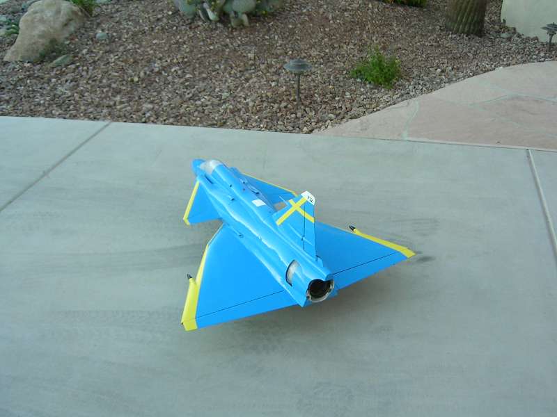

Hi John, Great Job!!!, (what a ride!!!) with the rear C/G [X(]

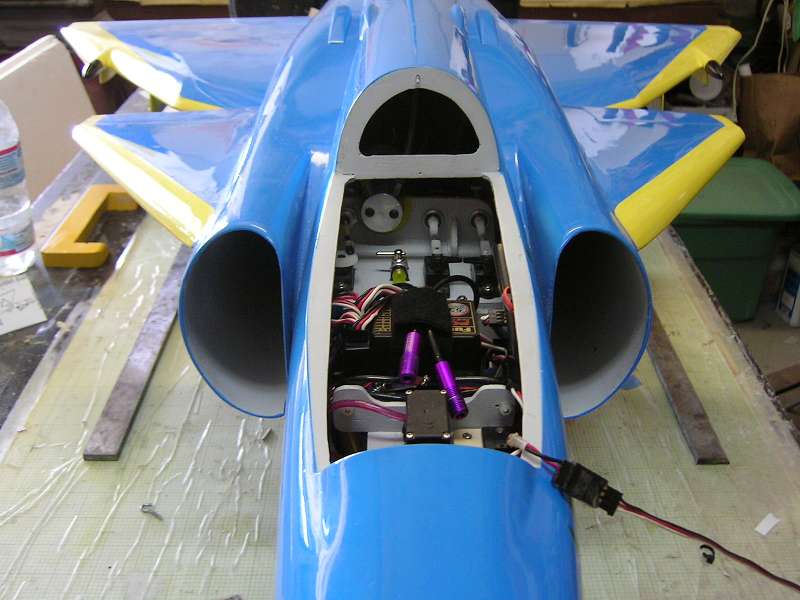

I want one!!! Would have to be huge though. Jet looks awesome. I see you have a scale main setup. Did you make it your self?

Yup, the gear was made "in house"...sort of. The horizontal trunnion piece was machined by my dad way back when and the struts are Robarts. I turned the piece that the trunnion is attached to and used JB Weld to bond it to the strut. I have been waiting for custom struts that were supposedly shipped from the Midwest the first week of February, but alas, they have not arrived yet. Hence, I improvised. The wheels and brakes are Trim Aircraft. As it turns out, the trunnion is a little too light for the heavier turbine model and I have bent it on some of the first "arrivals". I guess a bend is better than a hole up through the wing! Here is a picture:

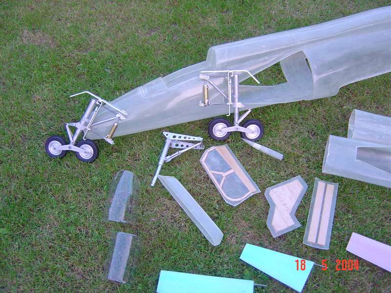

Hey John
Nice viggen.
I just have to show you this. This is the gear for my 1/8 scale viggen. That I hope to complete next year.

Nice gear Kim! I think that I have the plans for something similar to those. I wasn't brave enough to build my own retracts. For the mains, I'm using a set of Fiber Classics F-86 gear that I bought from Don Kanak a couple years ago. As it turns out, they have a very thin profile which as you know, is needed. Where can a guy get a 1/8 scale Viggen these days? Are there any Nauwa kits still available out there? My liitle Viggen is hard to see....Maybe I can get my optometrist to write me a prescription for a larger model so that I can use my tax-free spending account funds to buy one!!

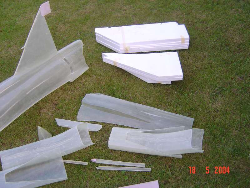

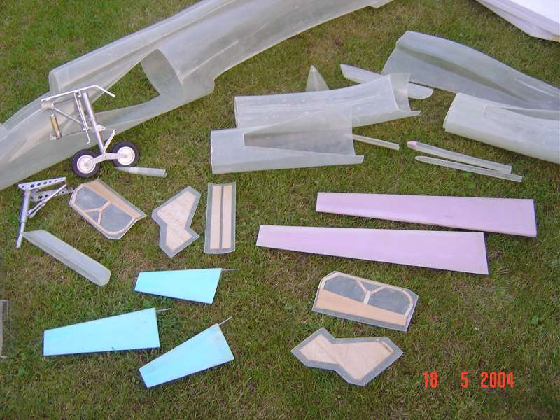

Hey all
Her it is. All the parts for the 1/8 scale Viggen. I have a AutoCad drawing with all the formers. But there is alot of work in this kit. But it sure is a nice size.
Yes it vill fly on a eighteen pound turbine, but I will go fore something a little bigger a SimJet 2300 ore P120 will be just fine for this jet.
