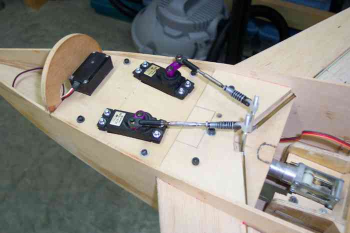

Countryboy's Avatar
My Feedback: (25)
Posts: 2,657
From: Lawrenceburg, KY
Default RE: Canard Servos
Look's like the Reaper is following in lines with the VW Beetle, " Built in every configuration that you could possibly imagine".
Mine will be using JR 4721's on all control surfaces. Hopefully, they will get the job done!!! I have too believe that I hold the record for the longest build on the Reaper... it's been along time coming.
