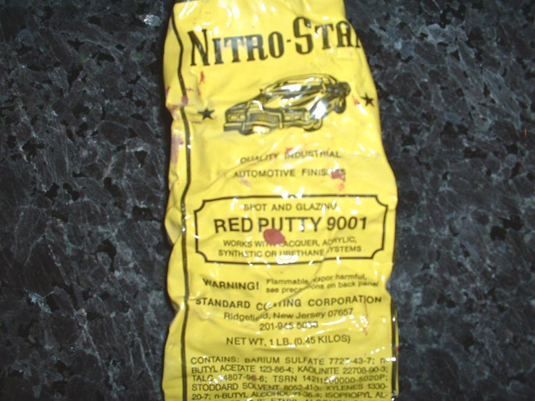

Default RE: Final filler
Go to your local paint and body supply store and get a tube of glazing putty. It is very light weight, spreads like butter, sands easier than balsa and it will fill any pin holes, scratches, and small inperfections. It will work with lacquer, acrylic, synthetic, and urethane paint systems.
David
