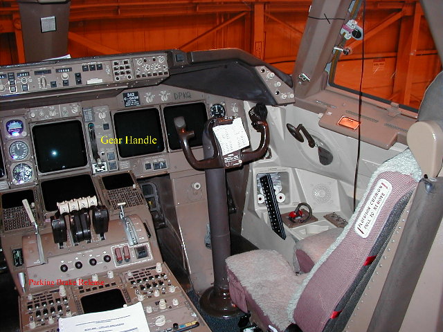

It's not very likely that could happen. Squat switches on the landing gear energize a lockout mechanism on the landing gear lever that prevents it from being raised on the ground. Also the controls are quite different and far apart on this aircraft.

YES!!
The parking brake level release is just the job for your feet on B744!!
The landing gear retracting need your hand to override the lock and put the level up!!!
No one will confuse about hand and feet.
Gear pin could not be right position!!! I could not belive that gear pin collapsed at that time!!!

Do the squat switches physically prevent the lever from being actuated, or do they prevent the gear from retracting even though the lever may be moved to the "retracted" position? I've heard tales of guys in other A/C hitting the gear lever on the take-off roll so the gear comes up the moment the weight comes off the wheels. It doesn't sound safe, but the stories persist...

The squat switch prevents the gear lever from being actuated. After liftoff the pilot not flying calls "positive rate" when the aircraft is climbing. That's the cue for the PF to call "gear up". I know we've lifted off when I hear the click of the solenoid allowing the gear lever to be raised.

Thanks for the firsthand info on the 747 gear and brake handle placements! On GA aircraft the squat switches are notoriously unreliable, and I know of at least 2 langing gear collapses in Bonanza's where the PIC moved the gear handle to UP instead of retracting the flaps after landing! Oops!!

During maintenance sometimes you will disconnect the weight on wheels switches and fool them into thinking the aircraft is airborne. Then you can do a "dummy retraction" with the gear pins in place and make sure all the hydraulics are working properly. The key is leaving the gear pins in! have seen this done many times, and only seen one dropped airplane. Most of the older generation of aircraft will allow you to raise the gear handle with the aircraft on the ground, the system is just locked out by the squat switches. Hope that is clear? Thought I would put my 2 cents in.
