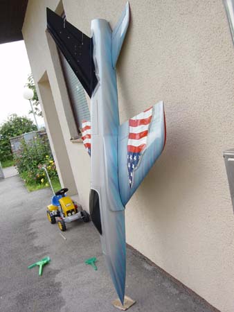

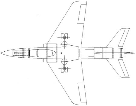

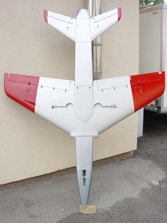

I am really starting to think about getting in to turbine jets.
I am looking for a kit that flies good and is not too expensive. Doing some searches i came across a kit called the Jurassic Eco. Has anyone heard of or seen this kit?
I did a search here and came across nothing. Here is the link and some pics. It is an all wood plane for a 12 pound turbine and retails for $250 which fits my needs.
Any help will be awesome
http://s104293454.einsundeinsshop.de...D28410300%3D29

the jurrassic is a beginner model certainly. It has very good flying characteristics. The construction of the fuselage is carried out with plywood formers and covered by balsa and the wings and tail units have a styrofoam core and are planked with balsa. The model on the photos (Amarican flag) weighs 8.8 lbs without installation. It is painted with car paint. The wing load is very low.

Hey Michael!
Your American flag looks great, except that short canopy you have put on it. I think it needs to follow Dirks original lines,
and go all the way forward to where the nose begins to slope.

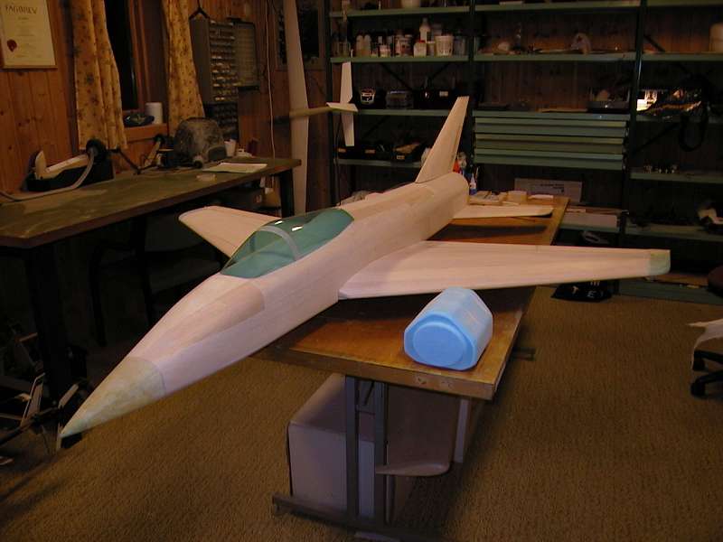

I made my own canopy, and tried to get the "Gripen" look on it.
