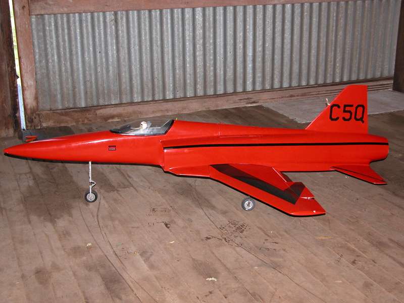

Have you thought about a Trim Aircraft Spectre? This one takes off in less than 250ft on an average grass strip. is relatively cheap with os91vrdf and ramtec fan will do around 200mph. Lands like a kitten aswell.
Matty

It looks cool too mate. Where do you get them in the States?

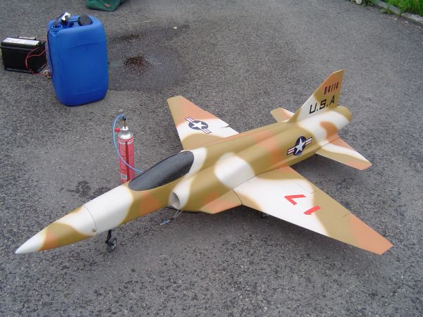

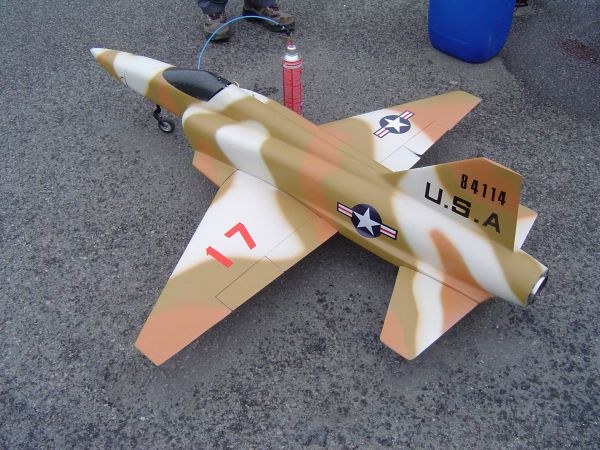

spectre modified for turbine.....
This is a cool jet :-)
