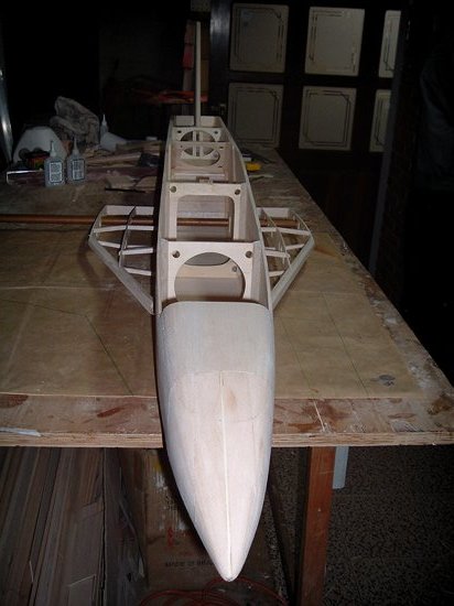

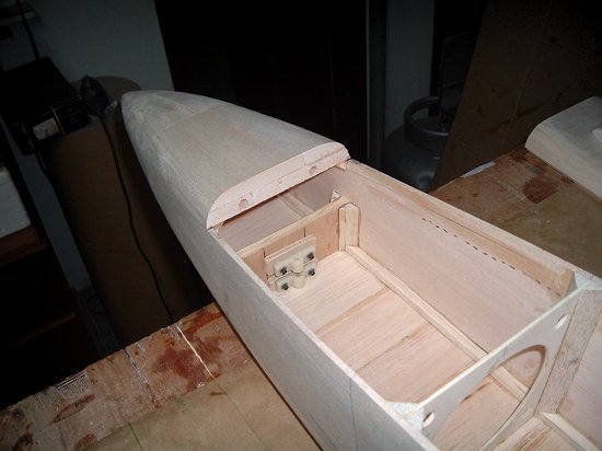

As promised, time to show some pics. After hand drawing the full size plans in brown paper, and printing the wing and stab section using the Winfoil software, we started to glue some balsa. The fuse sides are 1/4 inch balsa with a 3/16 balsa doubler from the wing tube location thru the tail section. The formers are 3 mm plywood unless the nose gear support that is 10mm . The crooked formers have 2 functions , to improve the tail rigidity and to anchor the turbine support plate. The overall lenght of the plane is 2 meters, has about 950 sq.in. of wing area and the projected dry weight is about 15 lbs.

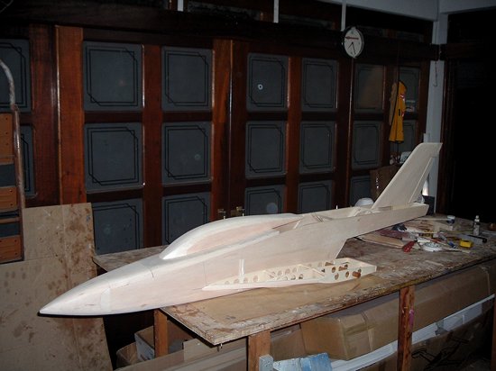

OK.some more pics. After venting some frustration after some mistakes, (first pic) we finally found the correct shape of the leading edge extensions, I printed again the airfoils, (naca 0007 at the root blending into a naca 0010 for the rest of the wing.) while I was doing this, Mr. Patake, the builder started to shape the laminated balsa blocks to the rounded shape and It started to look more like a plane! he also done the large hatch with the canopy, and the rudder that is built flat (a balsa truss with 1/16 side planking) we also reinforced the already reinforced fuse sides with a 3 mm plywood support for the wing tube. The LEX are also 3 mm lite plywood with lightening holes. No big problems found until now, and the building is been done very rapidly, mostly because we don´t spend time making fiberglass parts or a molded plastic canopy.

Old 07-29-2004 | 11:23 AM
erbroens's Avatar
Joined: Nov 2003
Posts: 4,292
Received 16 Likes on 13 Posts
From: Curitiba, Parana, BRAZIL
Default RE: treiner jets
wide angle pics...

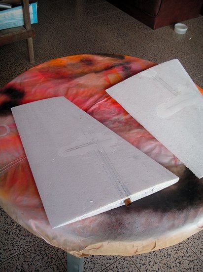

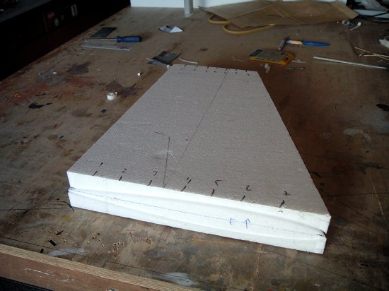

Time for more pics... The airfoils printed in the Winfoil software where transfered to aluminium plates for hot-wire cutting of the wing and stab. This wing are quite tapered and swept-back, so we used a reference marking at each tip to make the cut as accurate as possible, with one guy trying to match the number count of the other guy, and keeping the speed of the cut as smooth and even as possible. Btw, the airfoil at the outer panels of the wing is a naca 0010, with 2.5 degrees of washout... why 2.5 ? because 2 seemed too little and 3 too much! :-) the stab uses
a naca 0007 at the root and a naca 0009 at the tip without any washout. The wing incidence is 1 degree at the lex, and about 0 at the MAC and - 1,5 degree at the wing tip . the stab will be
set at about -1 degrees relative at the MAC. In the last pic , the foam core has a semi-rib that
anchors the wing tube guide.
