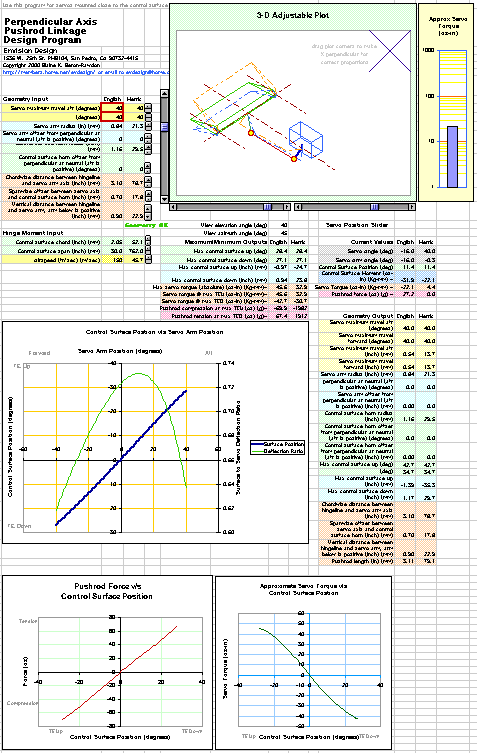

I have been using a program to help me do just what these guys are saying
The program helps calculate the linkage angles as well as the torque required at any given airspeed.
I have just been doing an elevator that requires 1.125" up/1" down travel...pretty typical. But I wanted the maximum servo travel. Turns out an 8611 can be driven about 58 to 60 degrees give or take in each direction. I feed that into my program and I can play with the arm lengths to get it right. Now the servo travels to its extreme limits to get the required surface throw
I also got rid of clevises, I rarely use them now except for pull-pull installs that do not have linkage slop in the traditional sense. I use helicopter ball links and dubro large ball links on almost everything else.

How can we get this program Mr. Matt?
Old 08-09-2004 | 10:13 AM
mr_matt's Avatar
My Feedback: (10)
Posts: 10,450
Received 13 Likes on 11 Posts
From: Oak Park, CA,
Default RE: 8411 slop?
http://members.cox.net/evdesign/page...ge_design.html
Believe me this is worth the money

Matt, That program is neat. No I don't have the second P-120 yet. I am still looking and fighting what seems to be a losing battle for the money. Tell Bob you need one for a good cause and I will pay $500 a week... Keep your eyes open for me.
