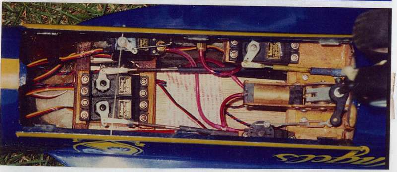

I've been working on this G&P Hornet for a while now (on and off) and I'm trying to figure out how you install the stearing arm on the rectract (nose gear) and have your servo hooked up at the same time. I've never done this before and I must say I'm baffled. If anybody has any pics or a good document, even the time to type it up, I'd really appreciate it.

Here is what another fellow did. I'm looking at the picture and it just isn't working for me. When the retract goes up, how does the servo linkage not twist off. I'm using spring air 101hd's so mine is slightly different, but if someone can explain to me how that servo linkage stays on the clevise with the gear goes up I'll take it from there

The steering arm has a brass rod that the white nylon piece slides on. The clevis from the servo steering rod pivots on the white nylon piece while it is sliding on the brass rod. So, when the gear retracts, the pivot point on the retract brass rod steering arm actually changes and keeps things from twisting or binding. If this doesn't help, I will plug the problem into my Marconium Wave Extrapulator and see what comes out.

The main thing is to make sure you install the steering arm with the steering tiller (brass rod with the steering horn on it) so that the steering tiller is pointed towards the top of the airframe. You can't get the linkage geometry to work with it turned the other way.

As was said already they nylon piece slides on the brass rod and when the retract is in the up position the nylon piece will be approximately centered on that rod allowing the servo to move in both directions.

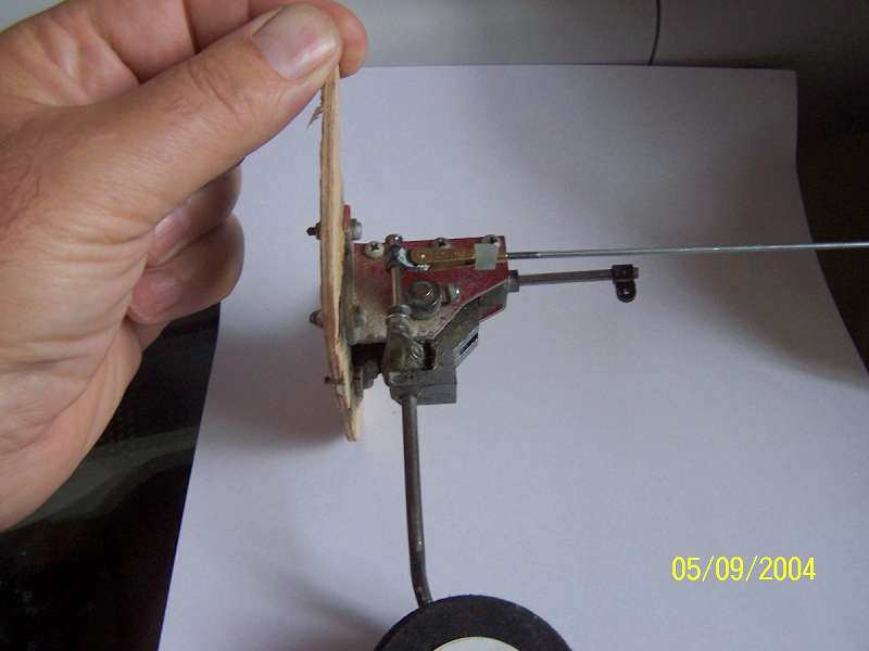

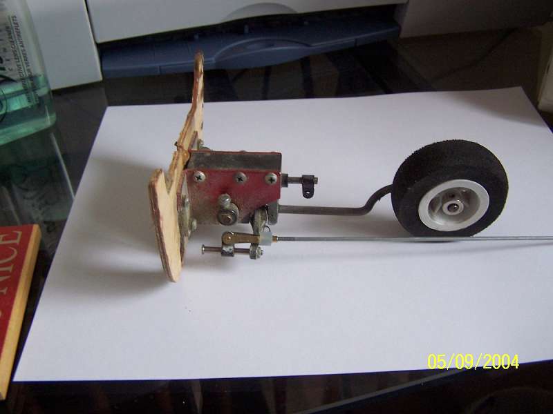

I took pics of one I had laying around...this might help explain.......

Thanks for the pics Nony. I think I got it. I'll let ya know.
