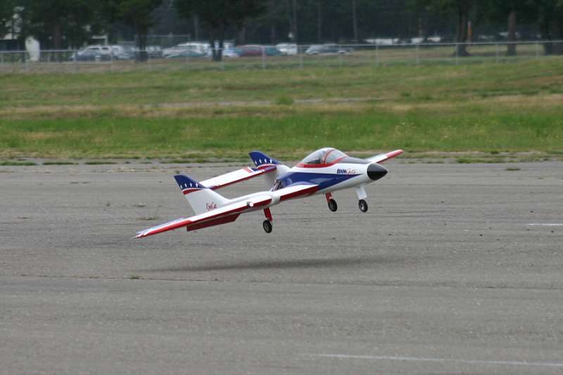

Great! So now we will have some smoking kingcat pics next week right?
