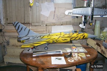

Steve,
I sent you an email about my PA Rafale for sale.

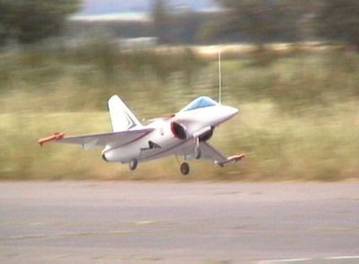

Here is a picture of Rafale flying in Thailand with PST J600 turbine. This baby belongs to Mr. Preecha.

very nice site and good looking Rafale. The Rafale here can take 2 liters of kerosene with 4oz header tank with total flying weight of about 7kg. Split bifurcated pipe is used here with less than 0.5kg thrust loss.

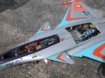

Just sold Avonds Rafale. I put a Mercury in it first and that was very very fast, but landing it was a pig. Then I put a Wren in it and it flew very well. The only trouble with it is that the inlet ducts are underneath and suck everything in, including loss grass.

You can make an FOD screen from a tea strainer ala Jetcat and save your little gem from nasty little pieces of gravel. You can probably find good stainless steel ones of various sizes at "John Lewis"
