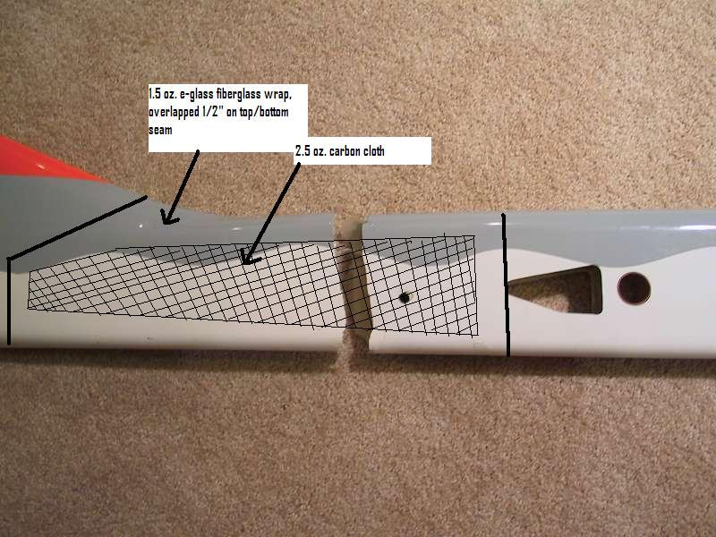

No question that the booms on the original run of kits was the Achilles Heel.....the rest of the bird is very stout, IMO.....the vacuum sandwich, semi-monocoque boom construction seems quite solid vertically, but prone to damage with any side load.....
The photos show what happened to my bird after I got a Kangaroo Hop going after touching down a bit too fast......the actual boom contact was not all that violent....no other damage to the boom or rest of the bird....all flex plates remained intact, but the side load snapped the boom clean.....I didn't even notice it until I taxied back and went to pick it up......there were no prior incidents that would have led to an unrecognized stress crack......the model was always transported on foam in my trailers, with the booms well supported.....it happend on flight #25...
While the Barry/Buck fix may be overkill, it really addresses the issue of side load on a long boom moment arm, with the fulcrum at or near the aft end of the center section-boom intersection, where mine snapped....
Tom
Tom

FWIW, and you probably already know this... that break is almost exactly where the booms broke in flight on the King Cat at the Maine Jet Rally. The structure in that area looks exactly the same on that one as well. I looked it over carefully since I had planned on ordering another one this fall. Everything looked like it was manufactured correctly with no obvious or visible building errors or defects. Seeing how there are failures without hard ground contact, your bounce was most likely just the catalyst, and not the sole cause.
I ordered a King Cat at last years Maine Jet Rally, but it wasn't delivered to me until late winter/early march the next year - 6-7 months
. I had planned on building it over the winter, but since it came so late, I sold it off rather than sitting on it all season long. I had decided that I'd order a another one in a different color and build it this winter. I wish I still had the contact information for the buyer so I could make sure he is notified of the problem with the booms, and get an fix kit from BVM. There is no way for BVM to get him a kit unless the buyer runs across the info somewhere and contacts BVM. Hence the need to get the info out to those people that bought the kits second hand, or otherwise not easily identified or traceable.

The location of the boom breaks on Tom's KC coincides with the breaks in mine (I hit the ground hard on an underpowered approach, not the KC's fault [&o]) and the cracks on Buck's booms. Having said that, in my opinion it is a weak area that needs to be reinforced on all flying KC's as soon as possible.
No doubt that BVM's fix will work and they have been very proactive in fixing the problem and making reinforement parts available ASAP. Kudos to BVM for responding quickly during such a difficult period (i.e. all the hurricanes and flooding in Florida!). [sm=thumbup.gif]
Having said that, I think it's important to get the word out...thus my post.
BVM's carbon doublers will no doubt work fine. As my second KC is an all-white version, I don't have any issue doing the overkill reinforcement, because it'll be invisible after painting.
Using Tom's boom pic, here's what Buck and I did...
Barry
Barry
