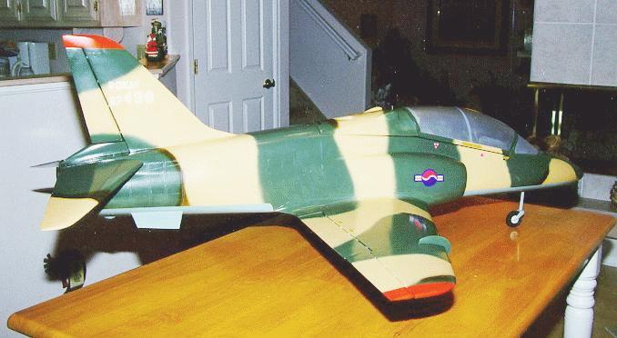

1Eye's Avatar
Posts: 1,106
From: Mesquite, Nevada
Default RE: Red Arrows Hawk ARF - Which Engine/Fan ?
growingupisoptional wrote ...
Quick questions are; is is a stable airframe?
Heh, heh ... depends on who you talk to and which model of the Hawk they've flown. Too much yank on the elevator and some I've seen are prone to depart controlled flight in a heartbeat [] I'm not an aerohead but I think the short tail moment/small tail volume has something to do with it. Yup, I had one ...
Mike
