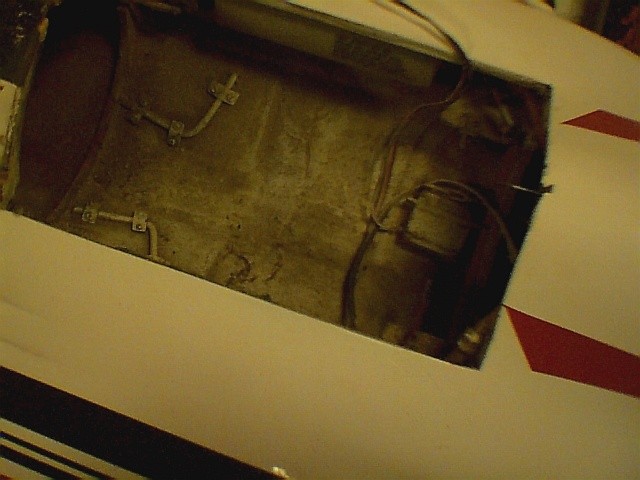

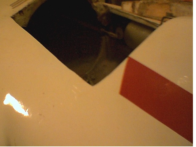

From the pictures the nose of that airplane looks more like a Byron than a BVM. Also what color is the fiberglass inside? Is it green polyester glass or is it yellowish white epoxy glass? Is there an inlet in it still if so what is the diameter of it where the fan would attach? It is also entirely possible that the plans don't match the airframe that you are looking at.
#32
RE: BVM F-16
the guy could have sold you one thing and given you the manual from another... does the hatch have a portion of the vertical fin on the back of it? only about 3/4"

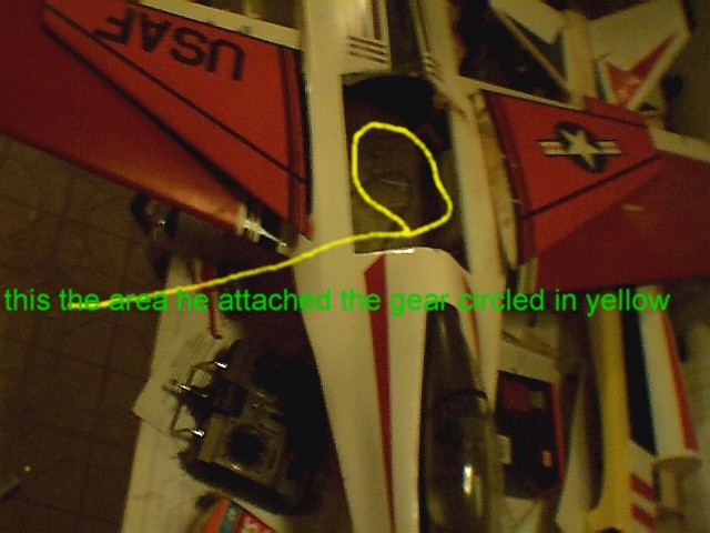

if the rear former is broken, you might try calling BV and see what a new former would cost. your other option is to create a gusset to cover the break I would go at least 2" either side of the break. the gusset should follow the same shape as the original former, basically laminating a piece to it. i would make it the same thickness as the original former.
i would not go crazy trying to reinforce too much on this. it will add weight very quickly.
I would compare the formers the gear is installed on against the documentation. My guess is that the formers have been modified to a point the bvm gear won't work. the price tag for the bv gear might scare you off a bit as well.
this thing is so tricked up from the original, i don't think too many folks here can help without actually seeing and digging into the model. i would not trust this particular airframe to a turbine. i would not spend any money in that direction. to the guys who have responded that know the BV F-16 intimately, not just the wings are different. bolt in whatever fan the guy modified this thing to accomodate, and see if it flies. and learn whatever you can take from this experience.

Well let's throw some more in. The Spare wings which are the originals are TOO THICK to be BVM. Yes I am talking about the ones resting above the jet. The pictures shows the hatch to be smaller (lenght wise) but then again. None of us are there to see it and the pictures are not that great of quality to give you a better understanding. But heck all these folks are willing to help. So shoot a picture or two of the inside and we can better pick ( err I mean help) you better.

I currently have a original BVM DF F16 kit in my hands and from the pictures provided I do not see any of the detail work molded into the fusaladge like BVM has. Like the re-fueling probe on the nose. I also see from the picture that the rear bulkhead does not go completly around in the fusladge like BVM has. Also these wings are too thick, mine are about 1/2" thick. I would agree that the plans you have are from BVM but the plane is defently not BVM. The original fibergalss body is white along with the front intakes.

Johnny, does the airplane have retracts mounts right now?? How is the fixed gear attached?
I agree with Pat, just try to enjoy the DF as it is, any further modifications may not be rewarding. It will still be fun once you get it into the air, remember that.
About the wings.........are they ribbed? foam?, glassed? I would not expect that DF to be too fast with that airfoil, however if you do go fast enough the wings may not hold, and break in the air.

Actually, the refuel port on a falcon is directly on top of the fuse, right in the middle of that hatch. Anyway, I am fairly certain that the jet is an F-16 made by a long-out-of-business company called West Coast Models. Fiberglass fuse, long wings, fixed gear. That's the bird, and the shape of the intake gives it away.

in responce to PAT First off Thank you very much the only other post with this much info was from David ribbe.
and yes it is possible that gave me plans for the wrong plane as he did have two F-16's and the other one looks quite abit differant than this oone, and no part of the fin is not on the hatch although i see in the plan it should be, and he didn't attach the gear to the formers it almost looks like there is a peice of lite ply or something under the fiberglass since just in front of the former that the hatch sets on there about 2 1/2" flat then a step downof about 1/4"and on this flat is where he ran gear wire thru the guy had K&B fan unit a 91 i believe and I can get the motor from him with a new head. maybe I'll look at the other one and take pics before I buyand post to make sure that it is the BVM.

Ok after some research it appears to be a jet hanger hobby f-16 based on measurements and materials used, I've decided I'll get the Ducted Fan that was in it, and fly it with that,
