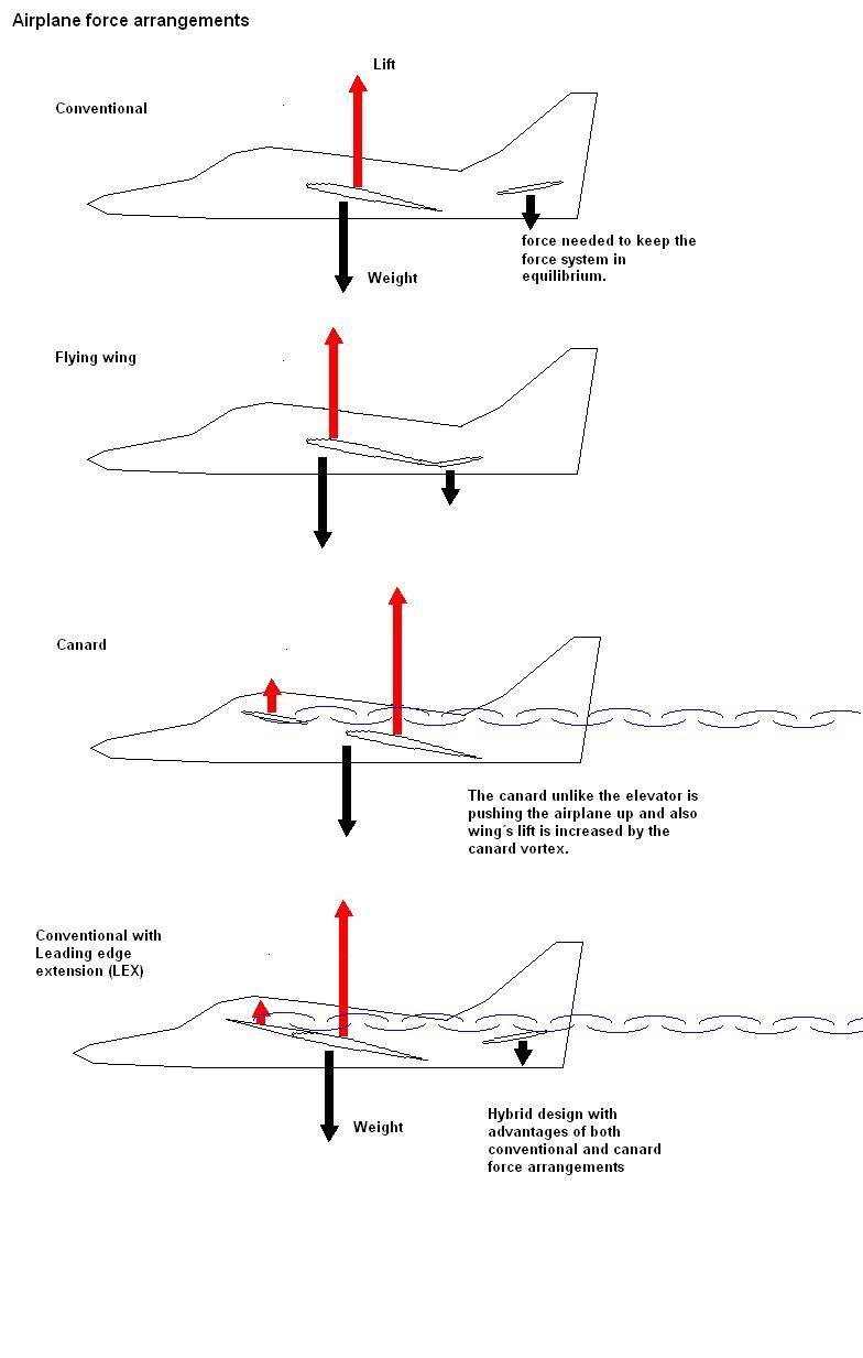

Canards not only help with avoiding stalls by acting as a lifting surface on the front of the aircraft but they also allow for greater and slower maneuverability.
Hi Dave, Canards help avoiding stalls mainly because of a low pressure vortex that flows over
the wing. this vortex lowers the pressure over the wing and delays the flow separation (stall) at high angles of attack. I also have this draw that perhaps could help. (excuse my poor english and translation).
Adavis, about your second question, the elevons can be used fixed, as elevators, or elevons... the best way to use them depends on the airplane selected and what kind of flying you want to
achieve.
Regards, Enrique

"Canard" generally refers to the surface used on aircraft whose force arrangements are based on the canard being the primary pitch control. The "foreplanes" on aircraft such as the Rafale, Eurofighter, Piaggio "Avanti", etc., are not canard aircraft in that sense, but rather they are 'multi-lifting-surface" designs. (As mentioned above, they assist in pitch, but are not the primary pitch control.) They can increase cruise efficiency, because the extra lifting surfaces help with the plane's equilibrium, reducing the balancing forces required (such as the above-mentioned constant down load on the elevator, in a "standard" plane) and allow the main lifting surfaces to be reduced in size, reducing drag.
The "Avanti" wing, for example, was able to be reduced 20% in size, by the use of the small foreplanes in the front. The horizontal stabilizer on that plane, (an inverted airfoil) which is still the primary pitch control, flies in an almost "no load" condition in cruise, reducing drag.
In a genuine canard aircraft, the force arrangement built into the aircraft is such that the canard is intentionally set to stall first. (i.e., the Long EZ) Theoretically, the main wing NEVER stalls, resulting in a safer aircraft.

Here it is a kind of pic that I love to see, the vortex condensation effect of LEX on a high g pull over the wings on a F-16 , same pattern happens on Rafales,Eurofighters, and even the Concorde, that uses a double delta wing planform to achieve the same results.
Regards, Enrique
