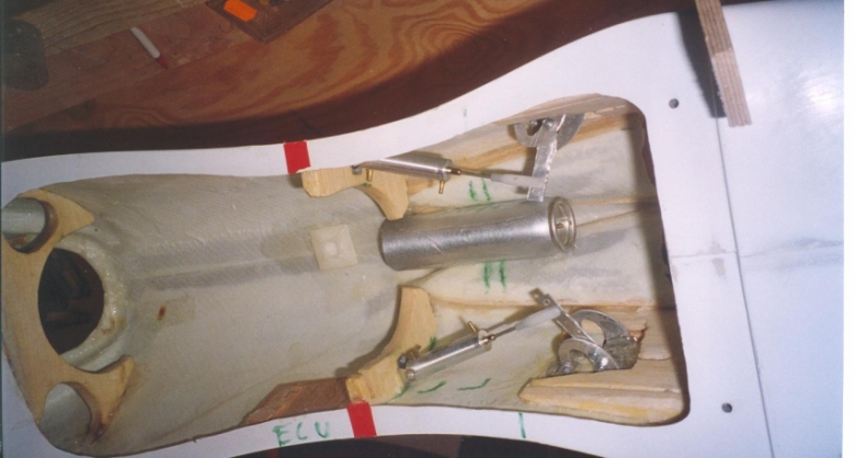

I'm trying to design a speed brake that will go on the bottom of a fuselage. It is for a senior design class i'm in. I know the area and shape I need but I'm interested in how to create the hinge point between the door and the aircraft.. I've seen lots of pictures of how it should look on the outside. i.e F-86 Sabre but I'm looking more for the internal servo and hinge point mount. If anyone has any pictures or can direct me to a website with some pictures I'd greatly appreciate it. Having never designed the internal part i'm kinda stuck.

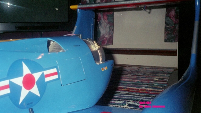

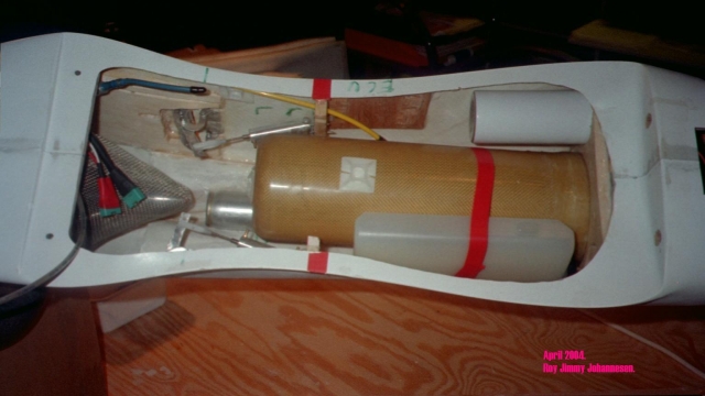

Maybe give you some more to work with.
Roy Jimmy.

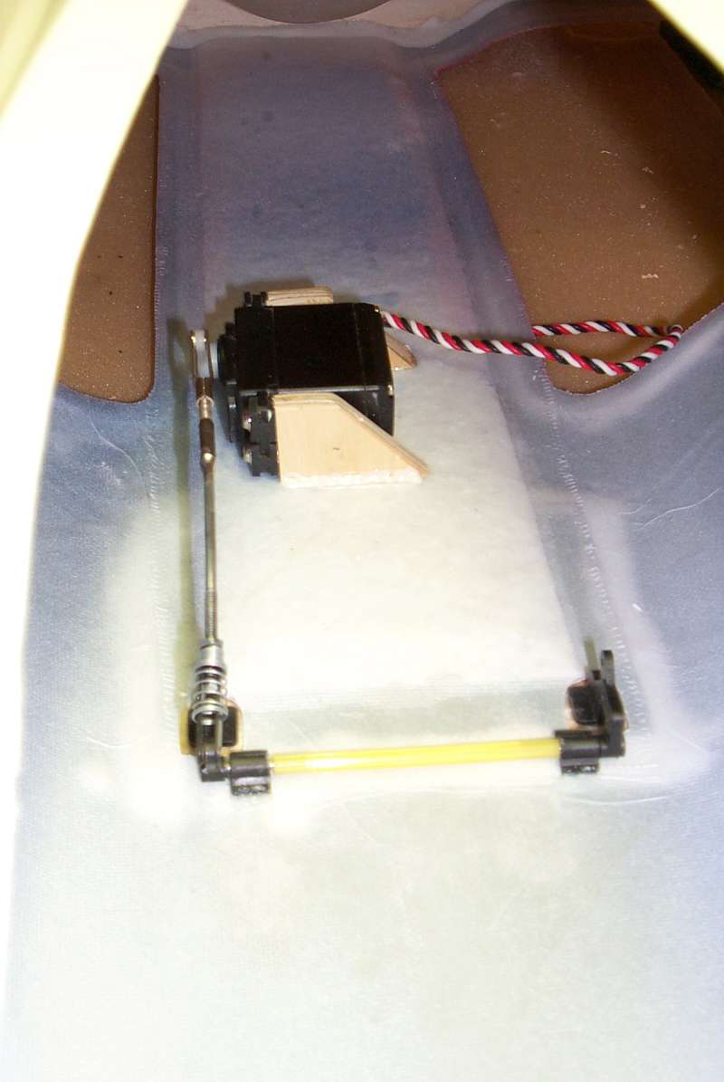

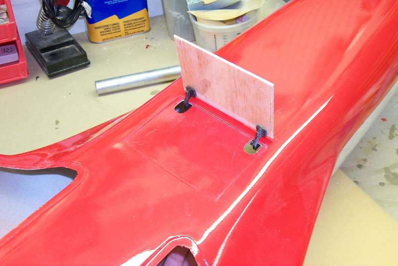

I'm more or less into a rugged construction, here some pics of my current project, an old Avonds DF F-15 which i'm modifying to "full scale" and dual KJ-66 turbine power. The airbrake is a selfmade carbon fiber / glass composite structure with hinge points at the scale location. The "hinge" is simply a steel wire going through the entire structure (uncut piece with overlength can be seen extending out of the fuselage in the second photo below). Bearings are simply small brass tubes epoxied into the airbrake carbon fiber "extension arms".
Take a look at the pictures....calculations show this will extend up to speeds of 130mph with the servo used (Extending 62°).
