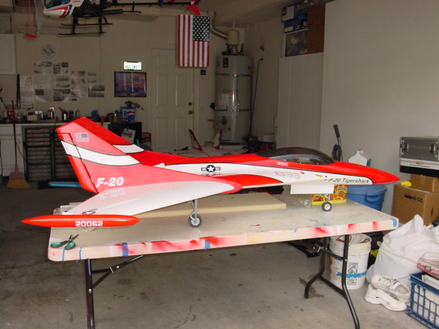

Hi, I can't figure out how dust nibs are attacking my fresh paint !I dont understand why I get them sometimes and other times I dont? I always give my parts a good cleaning and hose down the shop before painting can someone let me know whats up... Thanks

Yes I used before tak rags, but paint reacted to left over wax, so I now use just a paper towel .I painted today I didnt sweep or hose and no Dust Nibs it must be the water that they dont like? Well that problem solved the only thing Im worried about is a lawsuit! due to the fact I copied a well known paint style....

Jettset99,
I would bet some of those "dust nibs " are coming right from the paper towels you say you are using.
Every time that I have used paper towels, I have had a problem with fuzz, specs. dust or what have you.
Also, just the process of wiping the model down creates static electricity which acts as a magnet for airborne dust particles.
A little trick my paint and body brother showed me, is to use soft cotton, like a diaper, T shirt or the like, and wipe the model down with 99% isopropyl alcohol--not the 70% blend, as it is cut with oils. This helps to get rid of the static electricity charge, some what the same as putting a Bounce sheet in the clothes dryer.
He also told me to load up a paint gun with this same alcohol and spray it into the air prior to bringing the model out to paint. It is suppose to help remove the static charge in the air space and by doing that the dust particles will fall to the ground . He also suggested lightly spraying your clothes as they also are great dust carriers.
I have done all this and it seems to help....but then there is those pesky little gnats and skeeters to deal with !!!! I painted a wing once and really had a perfect coat of paint on it, went in to have a cup of coffee and bingo......a big ole June bug decides this is the only runway in the whole neighborhood to land on......and so it goes....get rid of one problem and have another.....

Paper towels are the worst thing to wipe down an area prior to painting. Always use a tack cloth. These are saturated with a type of resin---not wax. Do not press too hard, though---you could transfer some of the resin to the model. Use fresh tack cloths purchased at an automotive paint and supply store. The fresh ones are more pliable and work better.
Never use newspaper to mask a model off. This, too, will not only contribute to the dust nib problem but can ruin a paint job due to how thin the paper is as well as the potential holes in the newspaper allowing overspray through. Use automotive masking paper---it is dust free and solvent resistant.
When hosing down the floor prior to painting, let the water flow gently from the hose with the hose on the floor. No splashing!!! Do not spray using a nozzle or you will stir up dust as some have found. Sweeping the floor down the night before is best. Even in the best of paint booths you can still get a few dust nibs. Just wet sand with 2000 and buff.
I once had a moth get into my paint area. This little guy decided to do a little dance all over the model, leaving that "wing dust" all over it!!! He finally got stuck to the wing. When I pulled him off his body came away OK but all of his legs were buried in the paint. The model buffed out really well, though. Kevin

Ok all went well no dust nibs, tomorrow I will tackle the CLEAR COAT. I have had no problems using paper towels, I also like to use plain filtered water to clean the plane down,I have tried the auto motive tax rags and had fish eyes every were from them, so I dont like them, I also tried some prep cleaner that I got from a automotive supply house it left some spots, I might try it again. I have tried achol also but got some fish eyes also from it, so Im very careful on what to use! I will post some pics as soon as I finnish the spot!

Great job on the paint scheme. I love when people use curves instead of straight lines in a paint jobs.
By the way, what is that devil machine doing hanging over a perfectly good jet ;-) Jes kiddin'!
