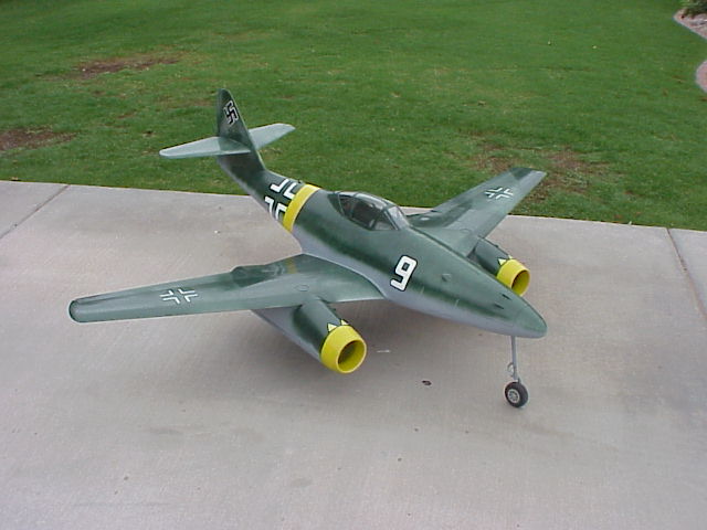

They can me "Vinnie spray can". I put the ole 25` finish on my jets. I just finished up an Air world ME-262 nad painted it with Plasticote spray cans (automotive type). The yellow is Krylon. I placed the first three flights on this jet Tuesday. Very nice flyer for an elec powered jet.
Tony F., if you are reading this, I got the elec figured out now. This one REALLY flys, I get 5-6mins of flight time and good performance, very pleased with it.
