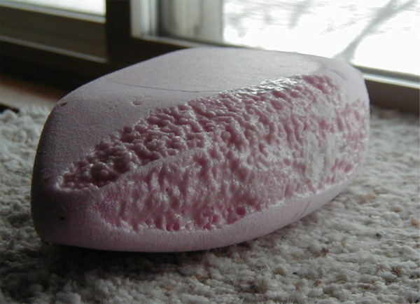

If it is a balsa sheeted foam wing you can use either. My preference is epoxy. If it is a foam (not sheeted) wing the polyester resin will turn it into a mass of goo.

In case you're curious about what poly does to foam:
