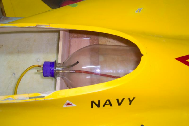

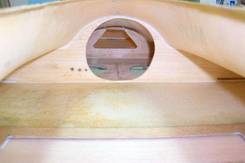

John,
If you haven't moved along with this already, I snapped a few pics to confirm that it can be done. You will also notice in the first pic that the front former has been removed. I did this in order too get at the wing roots so that I could glass them where the fuse had split open at the seam.

Old 01-16-2005 | 02:22 PM
My Feedback: (8)
Posts: 112
From: orange Co., CA
Default RE: Roo 2 Tank
Countryboy,
Good pics, they are helpful, thanks. My Roo has the foam herex formers that are very weak compared to the balsa in yours. I guess ripping them out if needed won't matter in the big picture but, I will start with augering out the rear former opening and if it won't fit then I'll R/R the front one and continue. BTW I also need to glass the seam at the front of the fuse inboard of the root attachment point for the wing. I hear it can separate and that could be catastrophic in flight.
