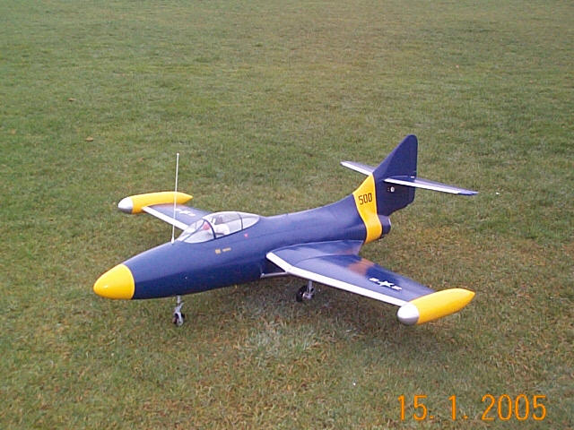

Thought you guys may like to see my latest jet model.
It was started many years ago but due to the very poor quality of the fuz moulding it has taken years to finish. It is so old that I started the build to take the original JPX 240 turbine. It was finished last week and now sports an AMT Mercury. The model is built from a Ziroli plan and to save embaresment I will not name the manufacturer of the fuz. Wings and tail are all built up and the finish is glass cloth and G4 resin. Model weighs 20 lbs which is 2 lbs less than the quoted weight for the ducted fan version shown on the plans. A home made fiberglass fuel tank holds 2.6 litres of fuel and the model is very scalelike flying around at 1/3 to 1/2 throttle. Take off last weekend on wet grass was no more than 30m and there was no wind. It flew straight with no trim problems at all.

A few points that may help you.
I used the Robart retracts and they work very well. You do however need to modify the nose gear mounting from the angle shown on the plan to get the wheel inside the fuz. I used Eurokit wheels and brakes and had to change the bushes in the wheels as the Robart axles are 1/4" and the Eurokit wheels are 6mm.
Don't know if you intend using the fiberglass fuz or not but if you do, you should make the rear former that goes up infront of the tailplane out of good quality ply as this carries all of the twisting loads from the tailplane. I would also suggest glassing it into the fuz with some tape. Mine broke some of the glue join during test flights. Luckly it is easy to repair through the tailpipe opening.
Hope you have fun as the model flies very well.

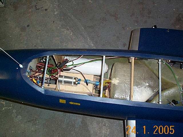

I have an AMT Mercury turbine in mine, not the HP type, and it produces about 8.5kg of thrust. This is more than enough and the take off on wet grass is no more than 30m in nil wind conditions. The turbine is located with the front mounting strap just infront of the former at the rear of the main gear opening. I used the Ziroli intake ducts and moulded a fueltank to sit between the inlet ducts.
I will take some pictures of the installation tonight and post them tomorrow.

Pictures of the installation below. Feel free to post any questions you have and I will try and answer.
Old 01-25-2005 | 03:17 AM
Joined: Oct 2004
Posts: 48
From: aldenhamherts, UNITED KINGDOM
Default RE: Grumman Panther
Try again with the pictures !!!

In answer to the question from Pete S-RCU about the tailpipe. I used the design that was explained in RCJI in the artical by John Wright. It was written around the Wren 54 but gave dimensions for other motors as well. I just scaled up the dimensions to suit the AMT Mercury. I did make a sliding mount so that I could adjust the distance from the motor to the mouth of the pipe and found that it did make a difference to the thrust. Thrust is now up on a bare motor...and it sounds good as well.
