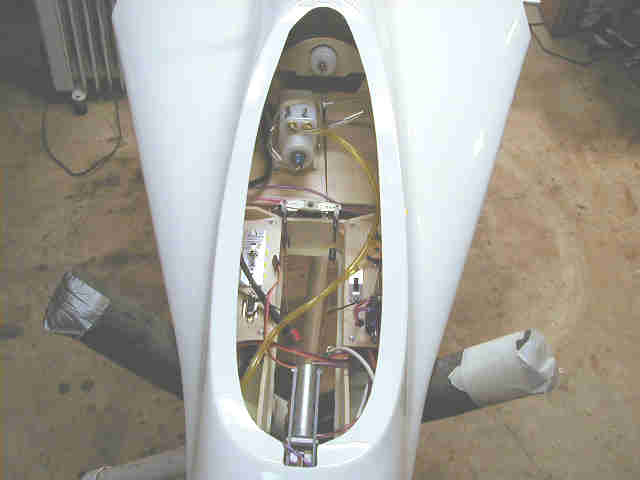

Johnny, I'm in the same boat as you i started a Hot Spot last week that i got in a trade with a guy. I need to do some research on that to.Over the weekend i installed the SlimJet 2300 and equipment for the turbine. I found some useful information here on RCU the
Unofficial Guide for building the Hot Spot. That's a big help being this is my first turbine. Good luck with your jet. dave

KAPTAN KAOS, can i ask you a question, did you glass in the wings i here you can but not a must, like the fins? And i was planing on putting a block of wood in the wing at the tube using a screw 6-32 to hold the wing on, how are you wing held in place? Thanks dave

Yes I glassed the wings and the verticals. I also put a strip of CF up the vertical fins for extra firmness. The wings are held on with a socket head screw from inside the wheel wells. They screw into a captive nut that I put into the wing. I brazed an extention onto the socket head screw for easy access from inside the wheel wells. I decided to use this method over the Graupner method. I did not like to see the bolt holes on the top of the wing.
I believe Todd W had something showing this set up in the past.
