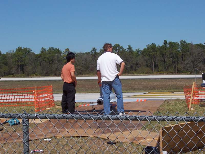

the main fuel valve was left open... I have done this... more than once... The result was when air
was shot into the engine to spin it up a mist of Jet A drifted out the back end. I sniffed it .. hahha.. and sure
enough it was fuel... Normally we pick up the plane and get all the fuel out of the engine.. But the
plane was just to large to do this... So I told them to go ahead and I will man the fire extinguisher
The result was of course a some what warm start... not bad enough for me to put out..
Some how during the startup lots of fuel made its way into the tail pipe then into the double wall
pipe... When I pushed the plane up the hill with the engine running, like Sean said, lots of fuel 10-20 oz
poured out the back of the plane onto the plywood... I stuck my head in the plane to see if the fuse was full
of fuel also, but it was dry...
Now think about this... The engine is running, fuel is getting blown by the exhaust out of the plane,
a lot more is just pouring all over the ground.. I mean how bad can it get.. ?
Nothing happened... The plane flew fine...
My point behind all this is.... I can not think of one failure or screw up during a hot fuel, that has
more chances of fire than what I just described... Thus my conclusion that hot fueling not a hazard in anyway..

I'm in complete agreement, there was a ton of fuel pouring out the back of that airplane, I just didn't want to over state it.
Turbulence, I can't answer for whether someone is not being courteous. That's a different issue. Someone asked how to hot fuel, I answered. End of story. If it was dangerous, it would largely not be allowed. Those that don't like hot fueling, are the guys that have the least need to do it. Reminds me of "old foggie" at my local field. Hot Fueling is "hip" "cool" , you know, like those tatoos on the back of those girls, or the nose rings in the local mall rats
Just kidding, I like to do it, so do others I fly with. I can't answer for someone doing it without a fire ext handy. I don't agree or disagree with that as I don't think you are likely to have a fire while doing it. I just don't see any danger in it. A wet start is far more dangerous to the model, and a crash is even that more far dangerous. A model airplane fire while fueling is not dangerous in my book as it's not going to harm anyone (too many of the old foggies will be saving your ***** so they can tell everyone how dangerous you are) interestingly though, that's not going to happen while you are hotfueling, it's gonna happen when you are trying to start a ram.

Can't believe anyone would accept a fuel leak such as that , or indeed any other. !!!
And actually its not that hot at the back of the aircrafrt, you can spray jet fuel into the tailipe, just aft of the engine exhaust nozzle, for smoke, and the fuel almost certainly won't burn, but fuel is a potential source of fire and its presence in the airframe as a result of a leak is totally unacceptable.
Fuel leaks of any sort should require an immediate shutdown and the leak cured before any further attempt at engine start, pretty basic airmanship !

we can find, but you still say its unacceptable...
Fascinating.. !!!!
