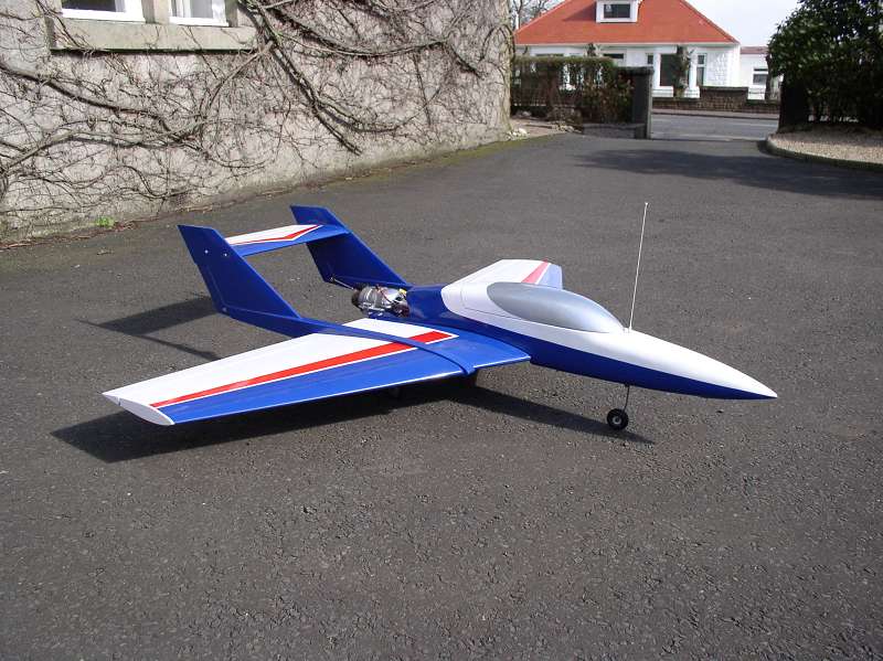

From what the other guys say about weight I reckon you could be around 10lbs with a 44. It will fly very well at that weight. My L39 is 9lbs and flys really well even though the wing loading is much higher than the 5 jet. I was really quite surprised how good the vertical was.
I have ordered one of these. 64" span and about 10lbs.
John
