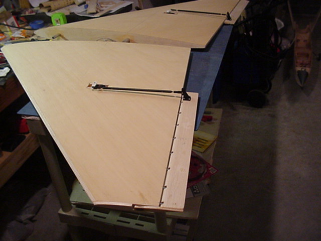

Sorry I missed this thread when it started. Here is a picture of how I installed the wing servos.
Vist my site for more photos:
http://www.houstonhobbies.com/reaper/
and for setup tips
http://www.houstonhobbies.com/jets/s...er-reaper.html
JR Gautreaux
