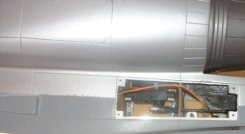

After many flights on my SM F15, I started to have probs with the elevator clevises. While the plane was apart I went ahead and replaced the servo arm with the new JR plastic arm with the metal ring around the screw. Its a smidge thicker than the average arm.
When I tackled the clevis issue, I went with the Dubro 4-40 locking clevises on the servo end and a swivel link on the control horn end. I switched to the Hangar 9 Titanium pushrods too. I like the Dubros because they are self tapping and the pushrods come with one end reverse threaded so I cannot come loose in flight. When I put the clevis on, the servo arm was just a tad too thick and I couldnt get the locking clip to go on the pin. I tried and tried and finally gave up. I drilled a 1/16" hole through the plastic part of the clevis and safety wired it together so now it cant come apart at all.
Before I fly it like that, I would like to see if anyone sees a potential problem here.

Although I am far from an expert, I wouldn't trust that setup. I could never be assured that the pin has good engagement to both clevis arms which is essential for a strong setup. I would opt for the thinner servo arm in that case. If you really want that servo arm, then I would investigate a clevis that would fit properly.

The pin goes all the way through both sides... I guess Ill have to try a different servo arm.

I would not use that set up. I'm afraid you have severly weakened the clevis, and like Topgun2mo stated if the clevis pin does not engage both sides, you may have a problem.

No expert here too. You will DEFINITELY have issues if the pin does not bear well on BOTH sides in a high load situation. There will be unwanted slop or worse. The solution is simple. I would simply remove a few thousands off of the thickness of that servo arm, locally where you need it. But leave full thickness at the root (where the max moment is) and be certain that there is no abrubt thickness change in the transition (too sharp a change would be a high stress concentration).

I guess I could just use ball links on both ends...that may be the solution. I just ordered a set of aluminum arms from Hangar 9. I have a set of the Dubro servo arms here. I guess I will give this some thought. Overwhelmingly though the response is not to use the safety wire. The pin does go all the way through, but I had the same concerns and I dont want to risk anything or anyones safety.

I ended up swapping control arms to one of the heavy duty dubro arms. Then the clevises snapped right on. I was using one of the new JR heavy duty control arms but like I said it was too thick and no matter how you look at it...it was a plastic arm. Anyone have probs with the plastic dubro arms?
