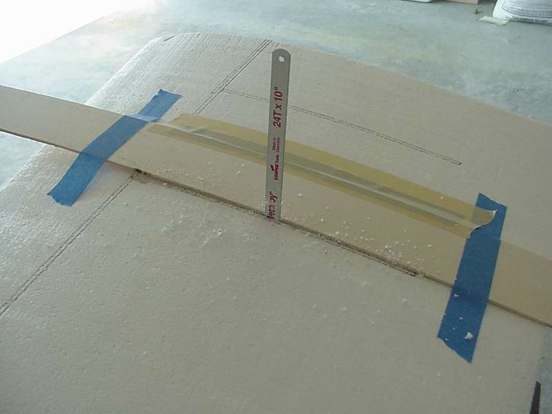

Started on the wings today. Got the channels routed for the landing gear spars. Will post more pictures on my website tomorrow but for now here are a couple.
JR Gautreaux

JR, a dremel works good for channels in Foam with the "Tile grout removing" bit. I tend to install wood in foam with poly glue, and anything that gut cut too much gets filled in during many different steps of the process. "Hog it out" is a phrase I am accustomed too.
If the tile bit is too short, a strategically inserted 1/8" drill bit works well also! I have a dremel router attachment that I can set depth of cut.

Thanks Sean. The airfoil is quite thick and I'm not sure a dremel bit would have gotten completely through.
