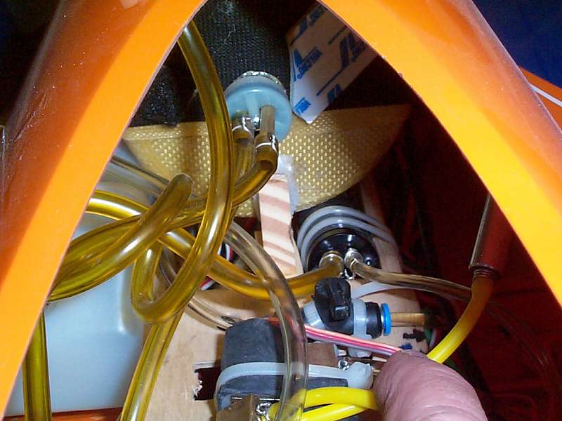

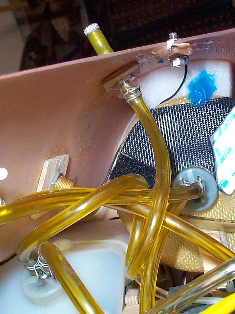

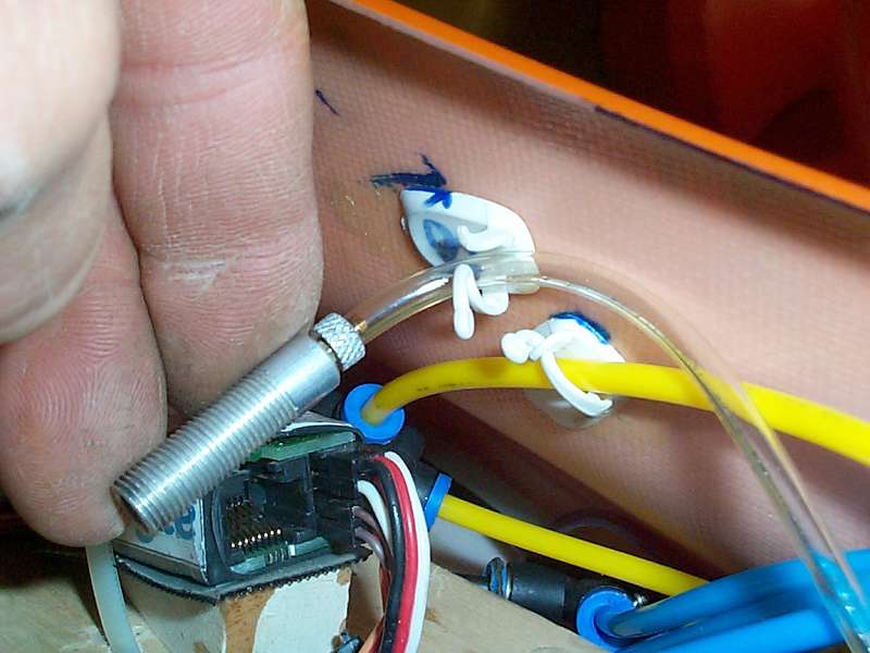

Old 03-30-2005 | 09:27 PM
MAX EFFFORT's Avatar
Joined: Aug 2003
Posts: 491
From: , TN
Default RE: Method of securing fuel lines
on my harpoon, I used saftey wire and spring clamps on plumbling. and i found those white, plastic, loop/clip, glue on, tube and wire hanger dodads at homedepot... velcro holds main tank in place with an easily removable padded triangular block of wood zap-glued in, to keep tank from shifting forward.

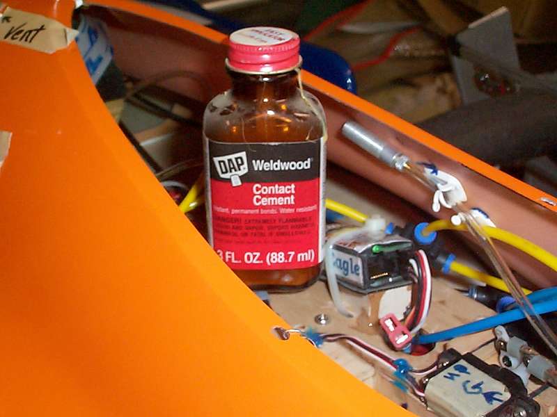

Old 03-31-2005 | 08:46 AM
Posts: 132
From: New Westminster, BC, CANADA
D.Kid I noticed the neat fitting/vent through fuse fitting you have. I made one for a plane but very clunky, what is yours made of/from?
Bart
Old 03-31-2005 | 08:00 PM
Joined: Aug 2003
Posts: 491
From: , TN
if i remember right, i think it is a dubro or a sullivan kit to convert jug caps to a fueling jug.

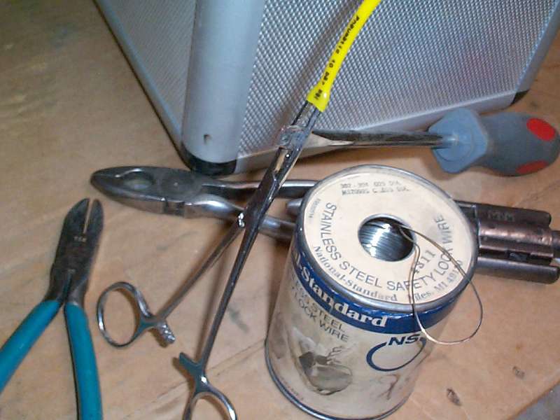

Old 03-31-2005 | 08:52 PM
cactusflyer's Avatar
Posts: 1,473
Received 2 Likes on 1 Post
From: Anthem, AZ
I use safety wire on ALL connections other than Festo. It is a pain to do the airlines, but after many memories of chasing leaks in Rhom-Air equipped pattern airplanes 20 years ago, I think that it is worth it! The solution to this pain was a tool that I developed. I took a "cheap" screwdriver like the ones that are used for promotional purposes and drilled a hole in the tip. I found a piece of brass tubing that would fit over the end when it was smashed into an oval shape. I then re-smashed the tubing into a round shape along it's length except for the last 1/2 inch or so. This way, the tubing is locked on the screwdriver. The brass tubing holds the wire in place while it is twisted. This tool makes the safety wire thing easy to do and it is easy to get into tight places.
The pictures show how to use it.
Tailwinds,
John

Old 03-31-2005 | 09:33 PM
Topgun2mo's Avatar
My Feedback: (45)
Posts: 1,097
From: Slidell, LA
Straight surgical hemostats are the best I have found for installing safety wire. Got plenty between my and my kids trips to the ER. Just ask after stitches...they throw them away!

Old 04-01-2005 | 11:07 AM
clguru's Avatar
Joined: Oct 2004
Posts: 224
From: Hopedale, MA
If your vent is in the top of your fuel tank, and the vent fitting is on top of your plane, then won't you lose fuel while flying inverted?
Normally you would put the vent out the bottom of the plane opposite the direction of the tank vent. Or does the fact that air is constantly flowing into the tank prevent that from happening?
Good Idea for installing tight tubing on those pesky fittings. I tried to get that 4mm stuff that jetcat gives you to fit on those solinoid valves. I had to put lubrication on the fittings, and then heat the tubing to put it on. Only works sometimes.
Dan
Old 04-01-2005 | 12:32 PM
Joined: Aug 2003
Posts: 491
From: , TN
I never have noticed any streaking or signs of fuel coming out the vent.. Think about this- when the vent trys to become a drain, then there is no vent to let it, hehe... If you notice in the pic, I have a loop in the vent tube for that reason (which may work better if it looped to the bottom of fuse, then went to top), but I would also assume that the flow of air into the vent also helps keep fuel from exiting vent when inverted.. Many guys do put the vents out the bottom, but I chose the top for several reasons ,similar to kevin #1- keeps belly slick and less possible damage in case of a belly landing , #2- not as much chance of fuel spills from residual fuel during transport, #3- less fuel on your hands, especially when removing taxi tank line just before take off, and #4- easy access is probably the biggest reason, not having to bend my wore out body over or kneel as much to attach or remove the taxi tank line... One interesting thing about a lot of r/c plane kits is lack of precise instructions on how to set up the equipment,. partly due to the many variables of engines types, tanks sizes, landing gear, etc and the placements of them.. This being my 1st turbine jet, I did a huge amount of research on it before building. There were many possible ways of doing everything to be done.. I took what I had seen others do and used the ideas that I liked best. Some things were my ideas, but not many..
