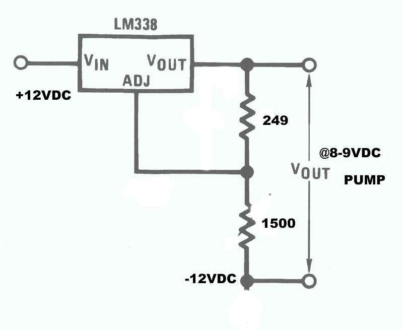

Guys I am trying to figure out what resistor to use to drop the voltage, from my 12 volt field battery to 7.2 volts, so my JetCat field box fuel pump can be powered using my 12 volt battery. Somebody has bound to have figured this out allready.

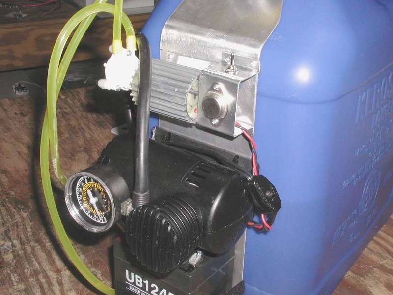

Here's the circuit. The 2 resistors are 1/4W or larger. The LM338 can be a T0-220 package. I had the lrager package on hand so I used it. Mount to a piece of alum to help with heatsinking. I used a reversing switch for the fill and empty function.
Here's the data sheet
http://cache.national.com/ds/LM/LM138.pdf
If you don't have the exact value resistors use the link below to see what will work:
http://www.electronics-lab.com/articles/LM317/
Dave Rigotti

Thanks Dave,
That is what I was looking for.

Here's the reversing switch wiring..
Dave Rigotti

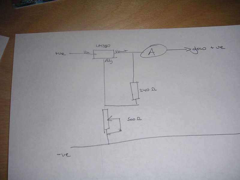

I imagine the same logic/circuit could be used to power a glow system in lieu of using a 2 volt battery.
Have you used a variable resistor with one of these circuits before?

You CAN use a pot to vary the output voltage. I think driving a glow plug from a 12VDC source is a waste of power. ALOT of "head" to overcome. Maybe a 2V plug from a 3.6 or 4.8V pack would be more like it.

lol rcguy,
I had just drawn just a similar circuit, before scrolling down...
oh well!
It was pratingly the same, but with a adjustable voltage reg, with a
set-pot, so you can change voltage if needed.

ORIGINAL: Topgun2mo
see this:
