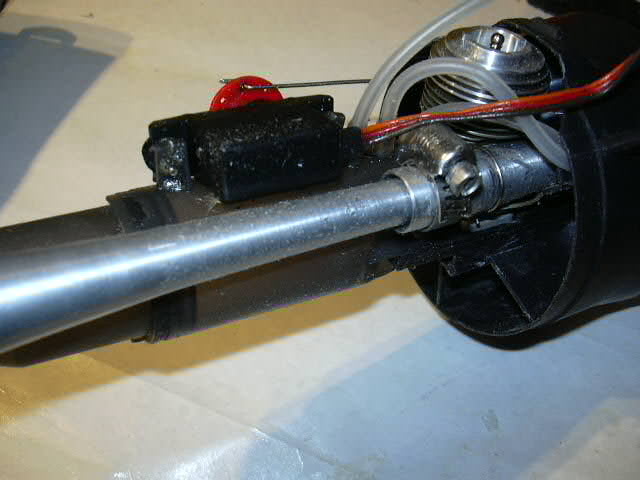

I have bench run it once or twice, seems to be good for 1000k rpm, have not flown it yet...

Don't forget to adjust your cg.
Is the increased weight offset by the increased performance? I have now flown mine a few times (so the engine has probalbly run about 6 times on 30% nitro) and so far, I am not excited by the performance but, it does create interest at the flying field!!

It's a CS(now G&Z) pipe mated to a Kamdax muffler.
It weighs less than an ounce. You can bet, for sure, a thousand RPM outpowers the extra weight!
1000k on a DF model is DRAMATIC.
Rory, look up some of the older threads I did on the Kamdax mig for performance tips.
